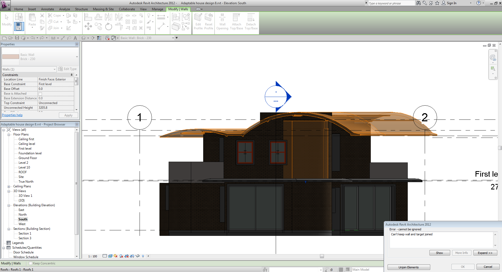

Happy New 2013 Year!Guys, I have problem attaching wall to the roof (see attached image). It gives me the "Can't keep wall and target joined" error.
I am new with REVIT (2 months), I work with REVIT 2012 Architecural.Here is the link to RVT file if it is helps... https://solidcam.box.com/s/dzwxni2ze5345cndhtghThanks in advance,Tanya.

try to make sure the wall face is aligned with the roof or vice versa. slight misalignment will have this error.

Error was found. The roof I created was created usin context modeling. In that situation attaching does not work. The roof should be created using roof panel.Thanks!
