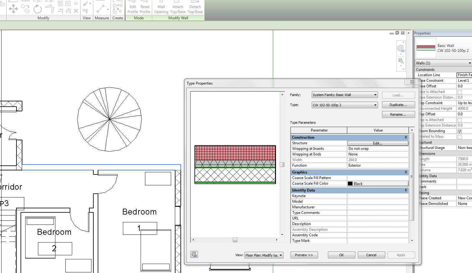

I want to apply multiple hatch to certain wall type and it goes visible in planI made multiple hatch example but I could not apply it to plan i also tried to remove the default pattern for wall type but still not workingand my version of revit is Architecture 2011
any idea ?

The fill patterns in walls is controlled by the 'material' and also set the view detail level to 'Fine'. Not Coarse or Medium.

yes , thanks , I always make simple mistakes like this , I should just make view detail Fine...thank you
