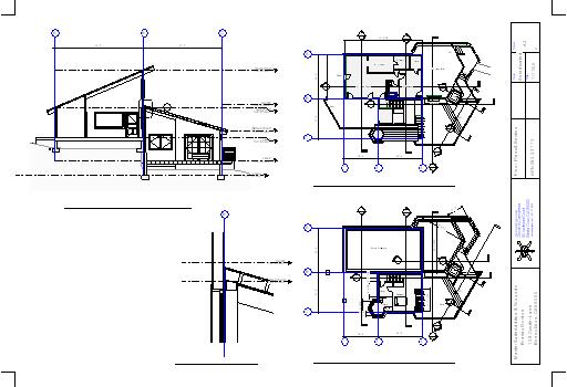

I don't know what happened, but all the view labels and bubbles on all sheets have disappeared? The line that seperates the view title and the scale is still there, but that's all. It did not notice when it happened. I'm assuming its a setting, but I can't find any documintation addressing this. I was just going to recreate all the labels, but when I created a new callout, the labels weren't there either. Callouts and sections are fully displayed on the model, so the problem is with the finish sheets only. How do I turn the labels back on? Thanks

Your view title tag sounds like its either been overwritten or corrupted. Reload the view title that you are using and then edit the title tags to ensure they are using the appropriate tag. HTH.

How do I reload the view titles Mr Spot? The attached file shows what I mean, only a line where the title and scale should be. Thanks

Select the viewport Go to its properties, Edit/new Then make sure it is using the appropriate loaded tag in the title pulldown menu. If it its and its not displaying reload this tag by going to Load Family and locating the family. HTH.

Thanks Mr Spot. I knew it would be an easy fix.
