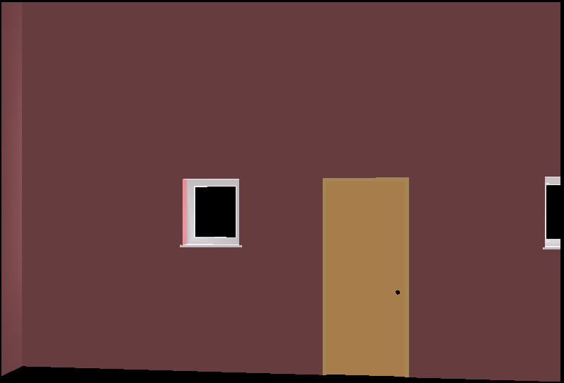

Guys I am trying to do an internal rendered image of an office block. When I render it, in radiocity the glass appears black rather then transparent, however, they are transparent in Raytrace My machine spec is as follows:- p4 3,2mhz 4 gig ddr 400 ram g force fx 5800 graphics card 2 x 120gb hards drives windows xp pro Any ideas?

Radiosity is the calculation of light distribution within your scene. You run the radiosity calculation (save it out to a file for good measure), then run the raytrace solution which will then use the radiosity calcualtion to more effectily distribute the light in your scene. HTH Tom

Did you select these Windows as Daylights? (see Design tab - Rendering, there is a Daylights button, if you want to make an internal scene, first select Display Model than press this button and select your windows....)
