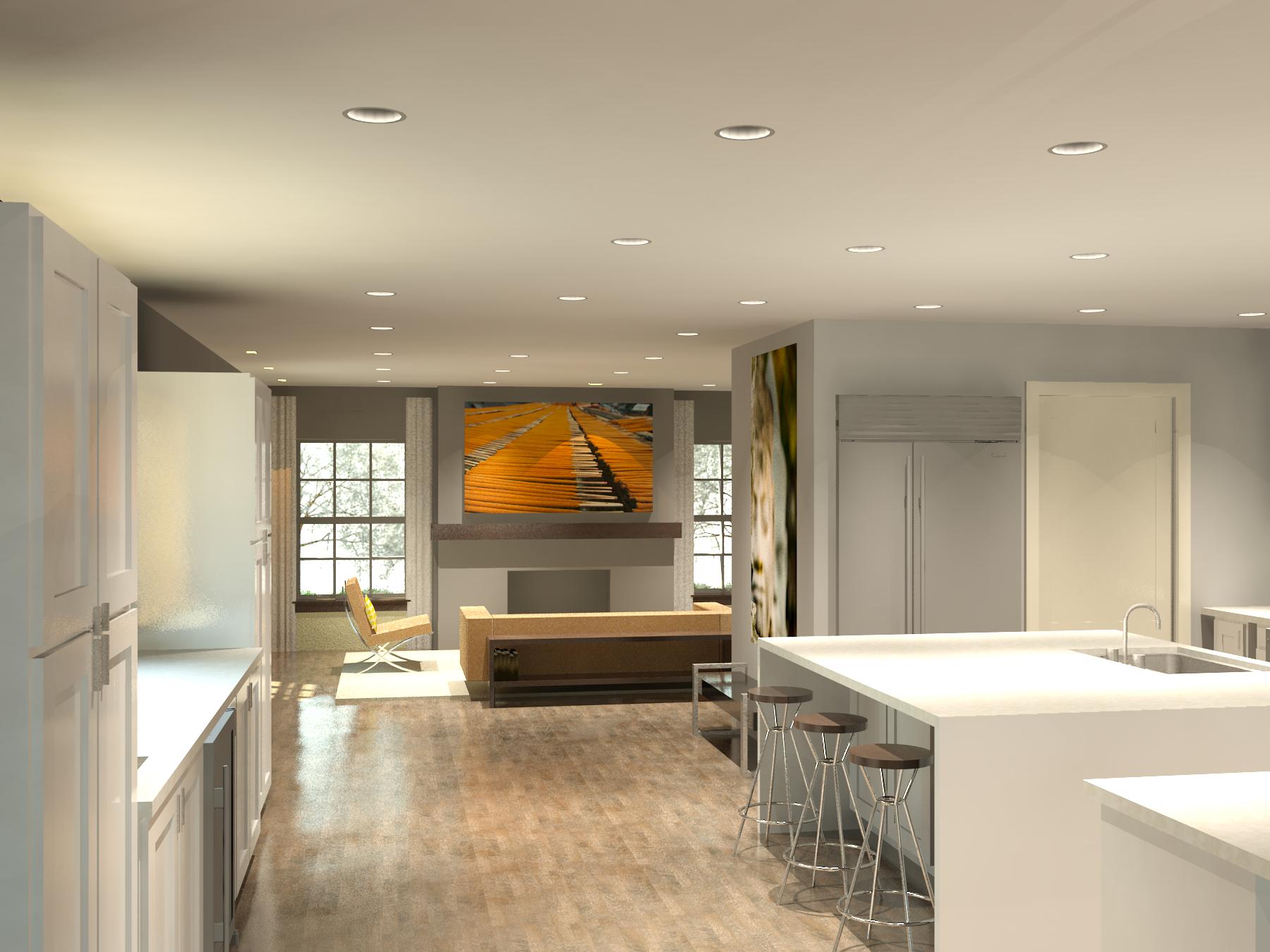

Issue #1:  I am rendering an interior view with sunlight and artificial lights.  The wood flooring looks awful to me.  It has a splotchy look to it.  I put the quality setting on 'High' and tried increasing the Indirect Illumination Smoothness to 9 and then, to 10 - neither setting worked.  Any tips/tricks to make this render more smoothly?

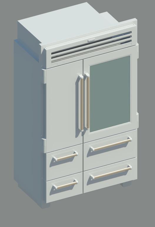

Issue #2:  I downloaded 3D Autocad models of appliances directly from the manufacturer's website (SubZero/Wolf).  I have tried assigning a materials parameter but, the appliances are still rendering flat.  I have used the same settings mentioned in Issue #1.  Any tips/tricks for this?

Please see attached rendering.I changed the glass panel and handles to show you the way.You have to modify the 3D model first. Exploded it, adding layers, I added three layers, face, glass and handles.Change the items to each layers. Then imported into Revit.Follow the same steps as in "Revit System/ Tips & Tricks",(I put under the wrong category), "Color control for imported SketchUp Files".Hoping that what's you want.
