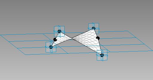

so the question is pretty straight forward. currently, i can only manage to create perfect hyperbolic paraboloid
edges without the surface. whenever i select the four parabolic edges (making a 3d closed loop) and then click the
"create form" command, revit gives an error that it cannot make the surface. what have i been doing wrong i can't
seem to understand. i'm at my wit's end.

just create a flat surface with adaptive point on the corners

ooh, i never knew that! thank you alabaster2513

See my article in the Augi World magazine, starting at page # 10 :
http://issuu.com/augi/docs/aw201205hr?mode=window&viewMode=doublePage
