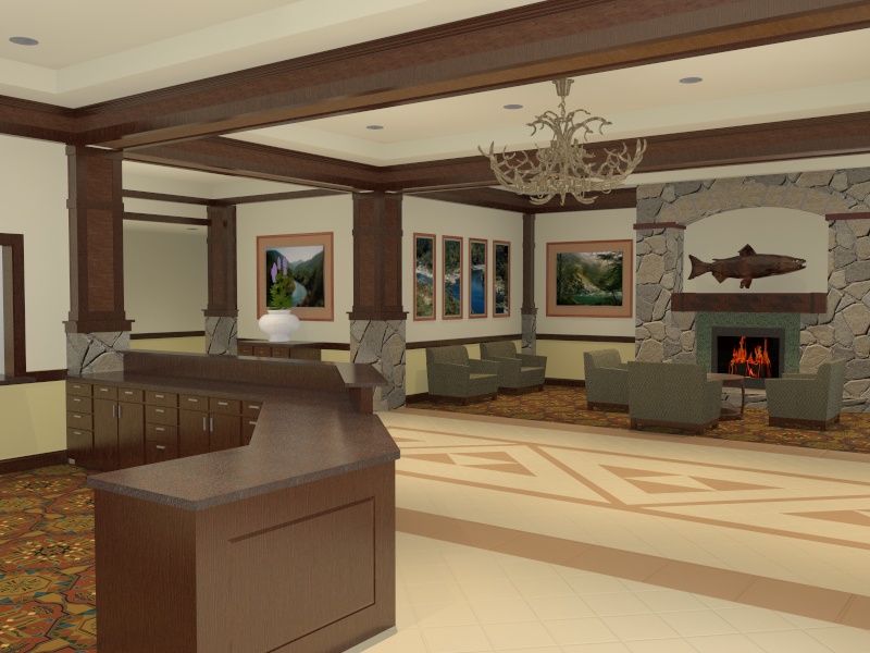

Don't do it the FBX way, just link in the revit file.  When in MAX, you've got to create a camera, then set your view to that camera and render.  Don't use the revit camera because the parameters will be limited, e.g., you can't change the revit camera lenses like you can with the MAX ones.  You also have to create lights in max to get it rendering right.  Here's a rendering I did linking revit 2013 into MAX 2013.

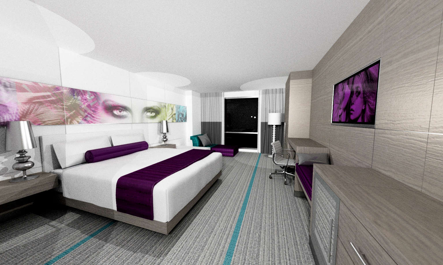

previously, i worked with interior scenes, i convert rvt to dwg and import it in max, because i used vray.. then i need to use vray mat and lights. http://ronmalit.wix.com/design#!porfolio/c199t

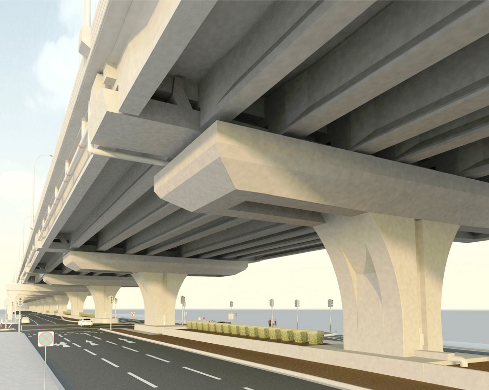

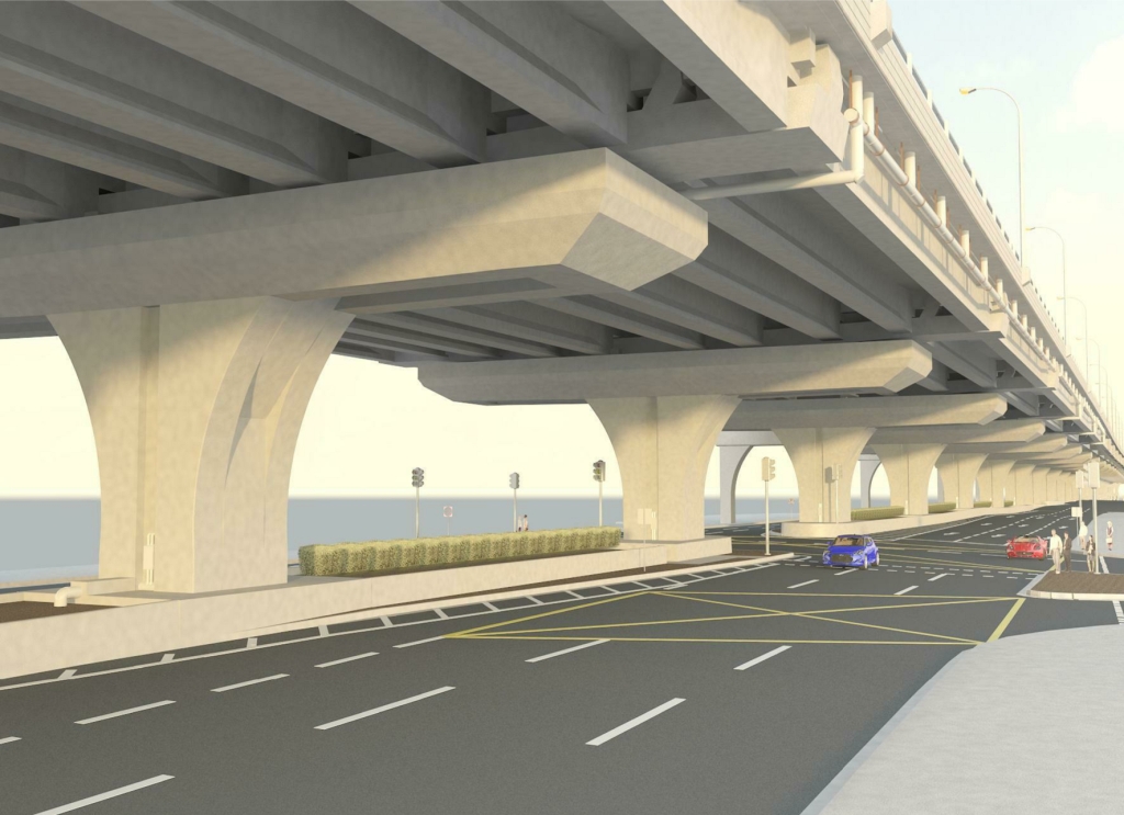

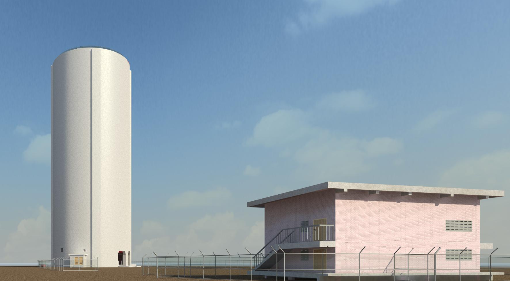

having these encounter, i sticked with our beloved revit to render, happy with it, just took me 3-5mins to render. mind if i share?

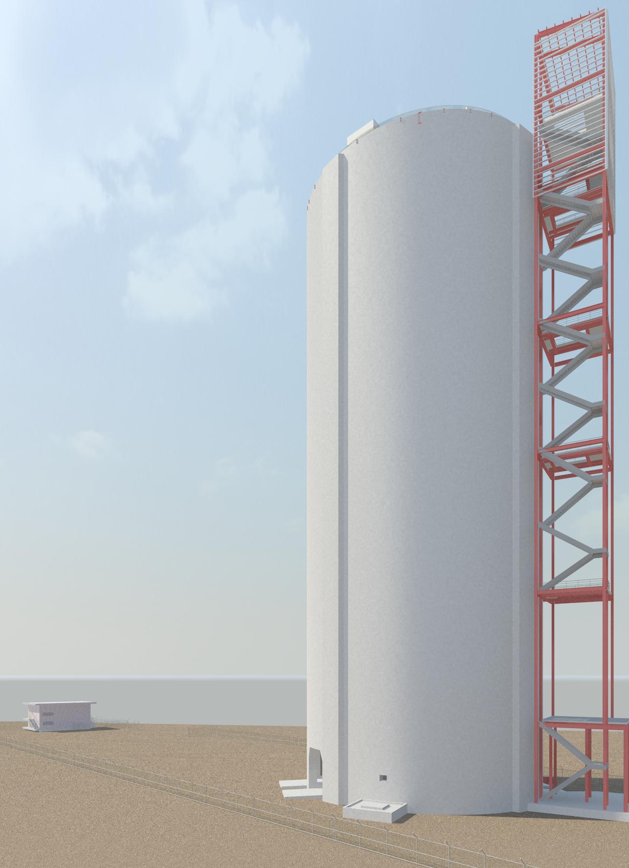

the attached image is a draft render with VRay RT done in just a few minutes
