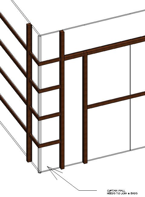

Hey I need to have a curtain wall join at a corner..How is it done?
I dont want a corner column or anything.
Thanks!

You have to "disalow join" those CW then you can stretch the endpoints, Check your help for that.
Wed, Dec 12, 2012 at 10:10:58 AM | Help ...Joining curtain wall corners!!!
Ty - The problem is the top, bottom and horizontal mullions will not be correct if the CW does not extend correctly.
I believe the last time I did this, I added a CW, vertical grid just off the corner at the joining CW glass face.  Then I did not use a vertical mullion on this grid or the end grid and I used empty panels in the sliver that was created.

@WW.. So if you created empty panels. a).Did you go ahead and create horiz. mullions? B). the empty panels that were created what did you fill them with? And did you actually have a corner?
Thanks for your help.
Wed, Dec 12, 2012 at 3:48:17 PM | Help ...Joining curtain wall corners!!!
Your view requires all the horizontal mullions - just not the vertical corner (and my added vertical).

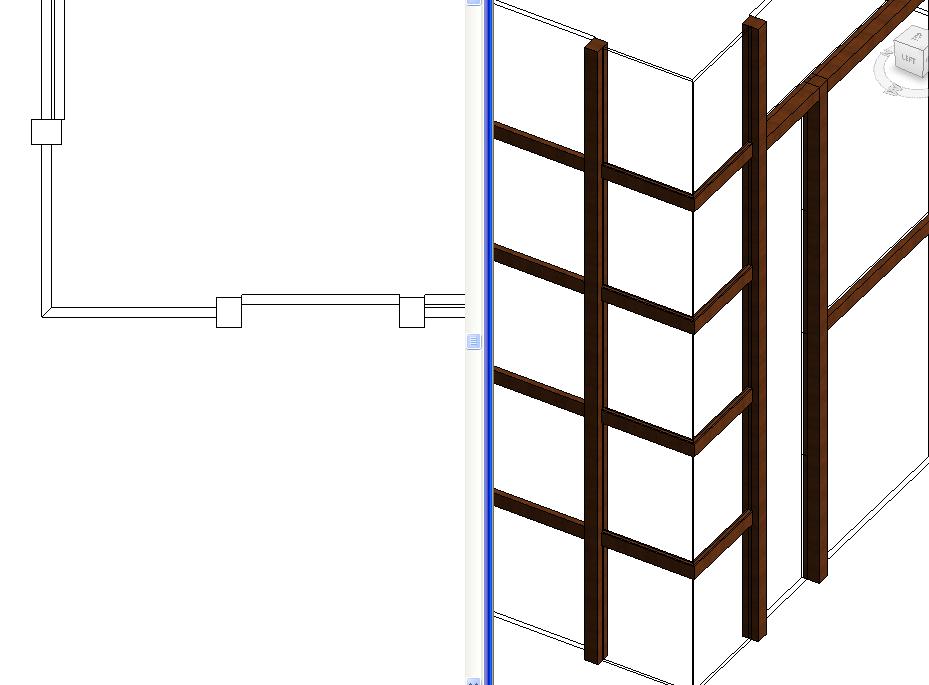

I found a way through internet searching..
I just changed the system panel to a custom glass wall the same thickness as the mullions..And it seems to work.
