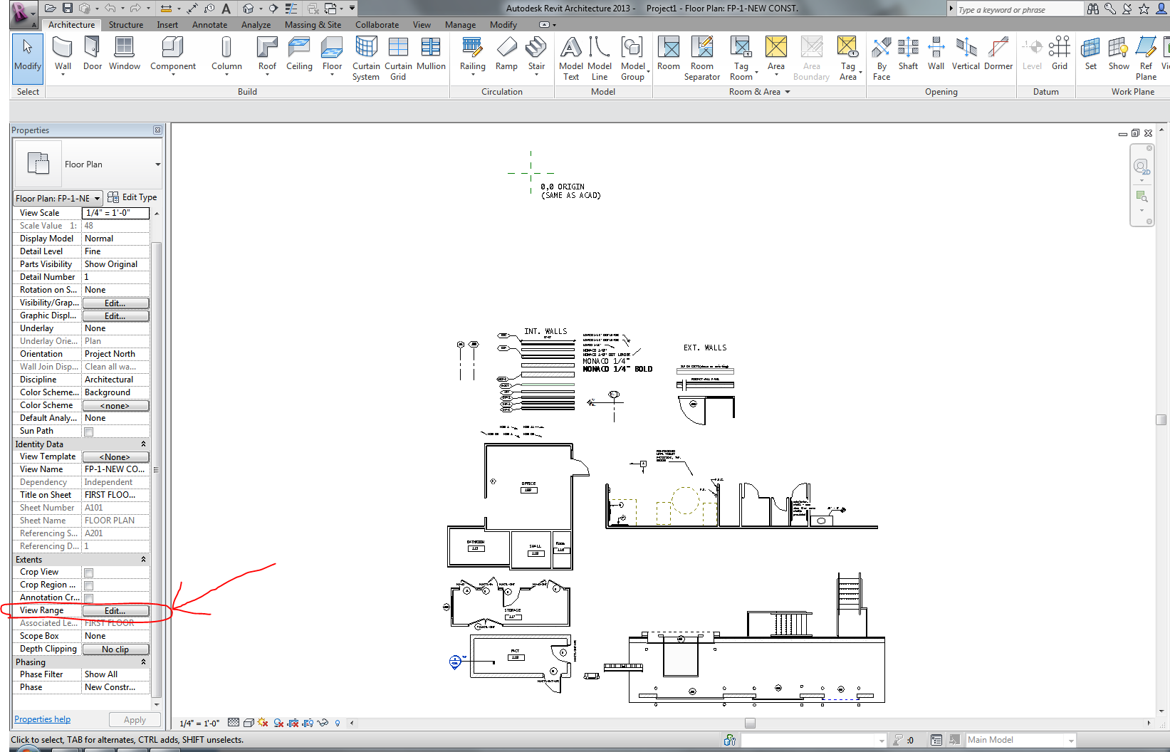

I'm trying to draw lines from light fixtures to light switches and keep getting the 'objects drawn not in view' error. I suspect it has to do with view range, but I can't find where to change the setting. I've identified the barrel vault ceiling constraints elevation is set at 0'-0".

Your view range is located in your properties under Extents
