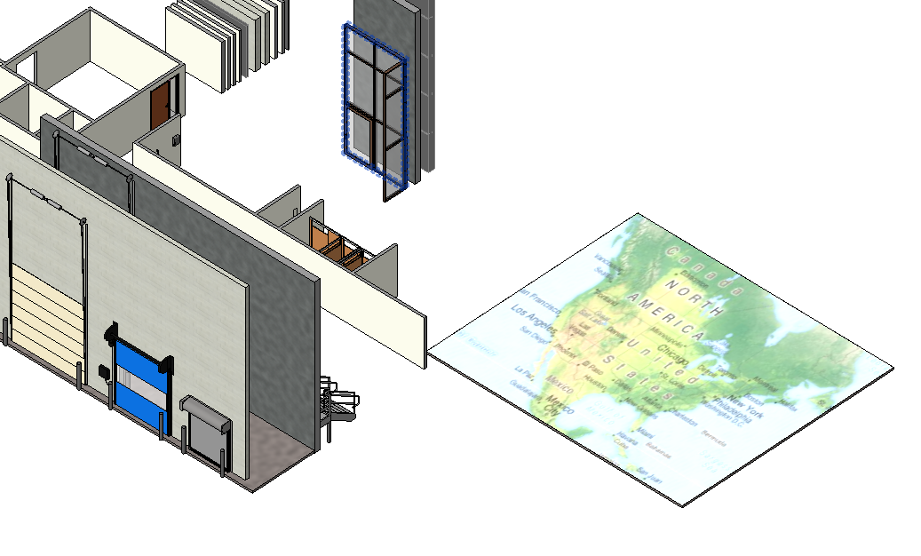

Hi,
Is there a way to insert lets say a image of a google map into revit where you could see the image while you manipulate your building in 3D view?  I know you could insert images into vasari where you can still see it in the 3D viewer.
Thanks,
Mon, Dec 10, 2012 at 2:50:45 PM | Image inserted into 3d
teafoe5
teafoe5 Avatar
Joined: Fri, Nov 12, 2010
1749 Posts
4 Stars: 47 Votes
Image instances cannot be placed in 3D views.  You could place a thin floor and attach a decal of the image to the floor that way it can be seen in a 3D view
Mon, Dec 10, 2012 at 2:57:50 PM | Image inserted into 3d
fellahzbstylin22
Joined: Tue, Aug 9, 2011
5 Posts
teafoe5,
Thats a good suggestion.  will the image only show in realistic view.  Since this is a big file it will slow it down dramatically.
