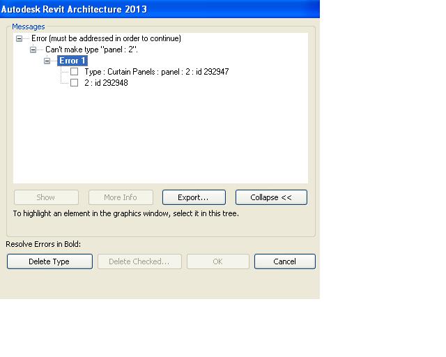

Hi, I'm trying to pin-point where the error might be in my family. All I'm getting is the information in the screenshot attached. If I check these errors and click "delete checked..." it works, but I'm uneasy about just just deleting it and would like to figure out what went wrong when I created my family...

When you change your family to type 2 it does not work with the parameters you have set.  You will need to flex the family and find out what is making that problem.  If you delete the Family type 2 and leave 2B it will load into a project and work just fine.
Fri, Dec 7, 2012 at 9:59:37 AM | version 2013_Error message when uploading family
Somewhere in your project, this panel does not work. Use the search by ID number to see where they don't work.  You may have to change those panels to something else there.

Thanks everyone! It turns out that one of my extrusions on panel 2 was set to 0", hence the error. Somewhere along the many iterations of this family, I had created a panel 2 and forgotten about it, so while I flexed 2B and it was working, I never thought to flex 2 as well...it's good reminder to check and make sure all portions of the family are working before loading into the project.
