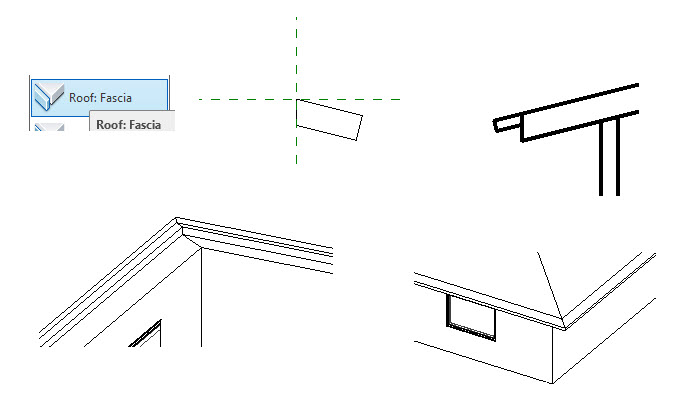

How can I do a roof done like the section of this picture?
http://www.ossosso.com/scambio/shooot.jpg
Thank you very much.
Fri, Dec 7, 2012 at 10:02:52 AM | Roof with an appendix
You can do that as two seperate roofs.  One is sketched as the thicker part.  The other is just the thin roof - then join them.

Roof fascia, with a profile, like this:
