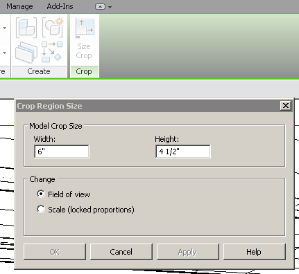

I usualy set the Size Crop to the paper size, if I'm gonna print in an A4 paper, I set the Size Crop to be 210x297mm and adjust the resolution in the Render dialog, for 150dpi most of the times. It turns out to be very good when printing. I think there is no point rendering an image too large if the print size will be small.

It sounds to me like a size crop issue. Clich the view extent box and scale it to be about half the size it will be printed at. THEN render at your chosen quality. It takes longer to render but delivers a quality image at the size ou need.
Or go full scale. I rendered a 40 inch image last month
