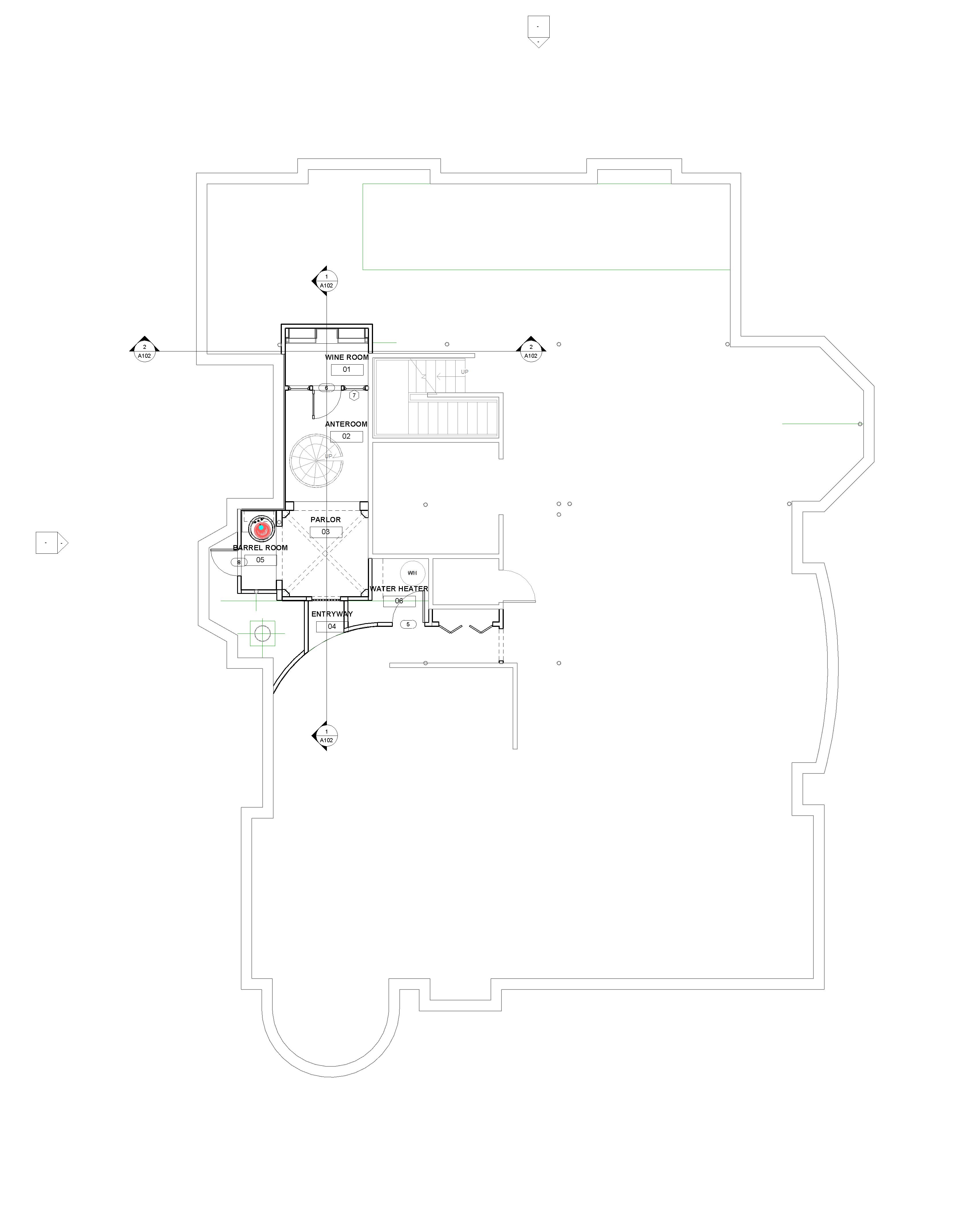

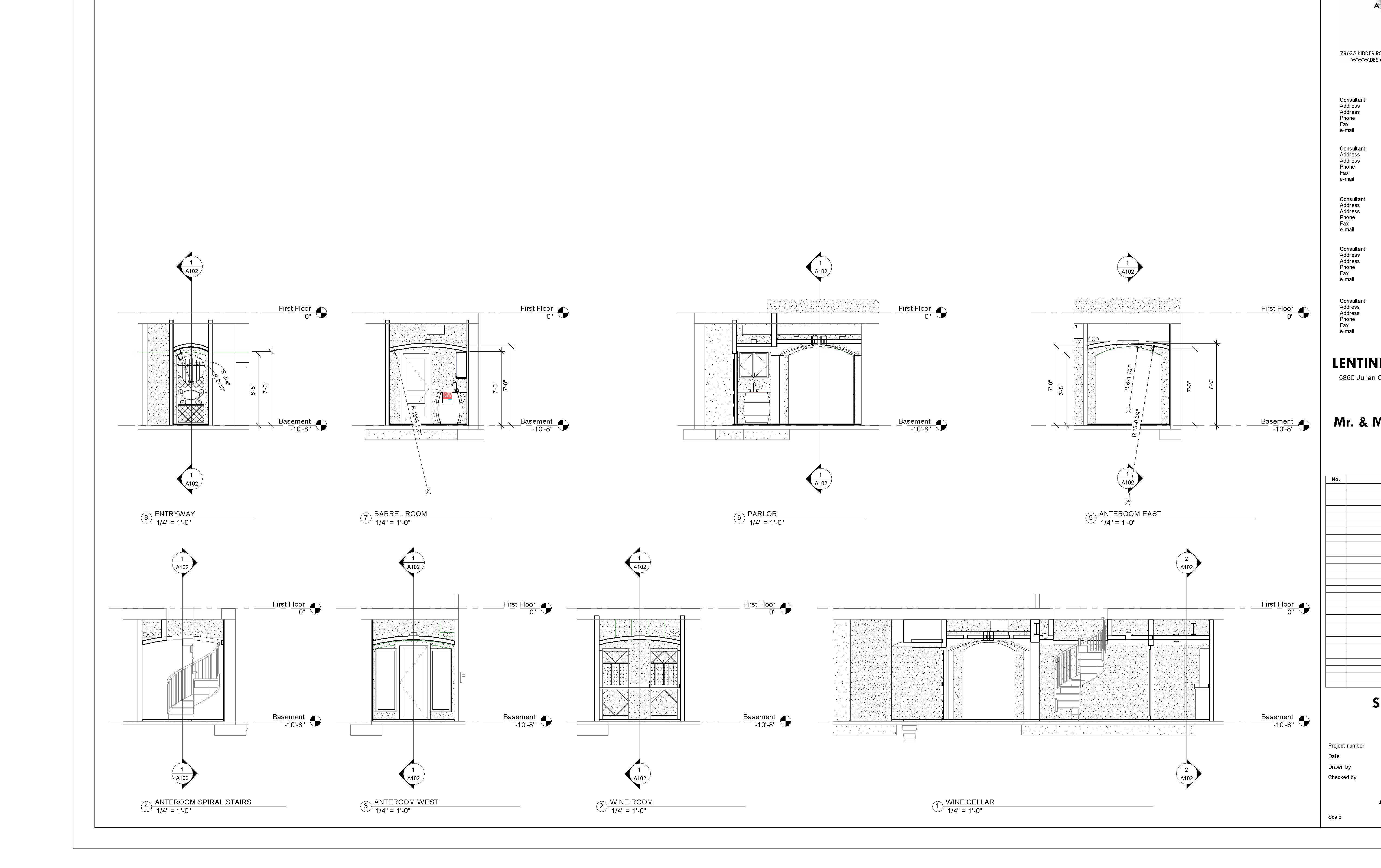

I've created section cuts in my model and dragged them onto a sheet. Returning to my model, I discovered the section cut lines have vanished. Going back to the section sheet I see that the missing cut lines have disappeared from every section I cut. I still have all my sections, but can't see the cut lines for them.

Here are some images. One is my section sheet with all the cuts. The other is my model plan showing only two section cutss.
I dragged the section views from the Project Browser.

Sorry about the quality of the image. Not sure what happened there, but you can see that I have only two sections on the plan but many more on the sheet.

If this helps, when I select a section in the Project Browser and right click to select 'Find Referring View' I get the following error message: 'Could Not Find Referring Object'.

Okay. After much web surfing, I finally firgured it out. I opened one of my missing sections and then had to go to the Properties 'browser' on the left side of the screen and under the GRAPHICS heading I found the HIDE AT SCALES COARSER THAN.  I changed the setting to the lowest, 1:400. That made the section tag appear on my plan. I then had to do that for all my missing section tags.
