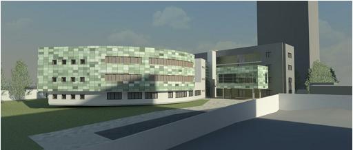

can anyone help-
i am trying to adjust the texture alignment with MODEL PATTERn on this curved wall- but it wont let me nudge the lines...
the result is a bad seam along the left side...
any ideas??

Add a straight line wall <same type> element joined to the end of this curved wall.  <You may have to pull back the end of the curve to do this.>    Then from a view perpindicular to the straight wall, aline - move your pattern, then delete the straight wall.

Doesnt seem to work....
eli
Thu, Nov 29, 2012 at 6:58:43 AM | curbed wall texture alignment
Try again.
The face of the wall must be at the same plane and the walls must be joined.
Thu, Nov 29, 2012 at 8:00:23 AM | curbed wall texture alignment
Sorry - my method has always worked in the past.  It appears that has changed - at least in 12 where I am working now.
Sat, Dec 1, 2012 at 5:47:58 AM | curbed wall texture alignment
Joined: Tue, May 22, 2007
5921 Posts
4 Stars: 205 Votes
Use the "Rotate" tool, here you have an old post: http://revitelemental.blogspot.pt/2010/05/aligning-hatch-patterns-on-curved.html
