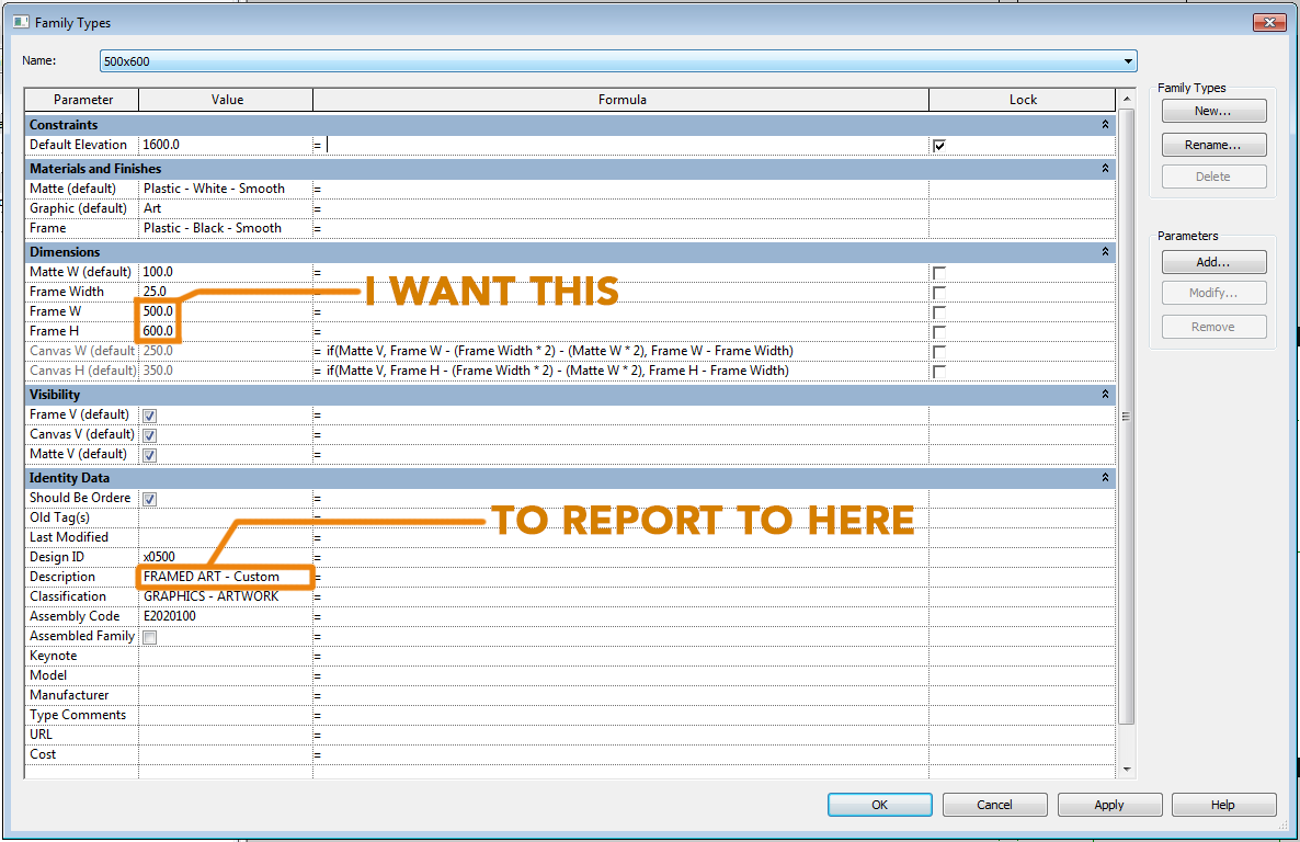

Please see the attached image.
I want my description field to report the Parameters Dimensions to be in the schedule. Right now we either are not specifiying artwork frame size or are manually inputing . . . either are not effective. The information is RIGHT there .  . .
Wed, Nov 28, 2012 at 7:02:59 AM | Can I have Revit do this? See Image - Formula Question
Paramter types are important in Revit.  Text in text parameters, length's in length parameters and length formulas and there is no text formulas available like "concat".

. . .  Sigh this is what I thought in my readings. Seems so simple and easy to have done. A field is a field and Revit knows what those values are anyway and storing as a name which can be called upon. So basically, it cannot be done? Do you have a suggestion for making this show up in my schedules?
