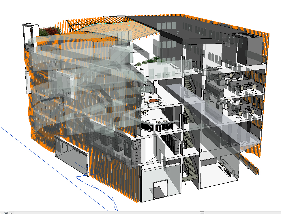

I cannot see 3D views in rendered appearances; they keep on being messed up with a strange transparency (mostly windows projecting through the entire building, ends of walls being transparent and so on).. I have avoided using it and have just used "hidden line" and going through prolonged renderings which works fine, but I can't do that for the 3D-walk-through I am doing for my presentation on Friday, I need to use either "realistic" or "shaded" and neither will work.
I am afraid it is my graphic card in my laptop that might be the problem (although it is a new quite advanced Sony Vaio with Nvidia geforce), but I am hoping that you recognize this problem and have a quick fix Cryingwishful thinking).
Please let me know if you ever come across this before and/or if you know how to fix it..

Graphic Card issue... Update drivers for that and in Revit Options disable "Hardware Acceleration"
