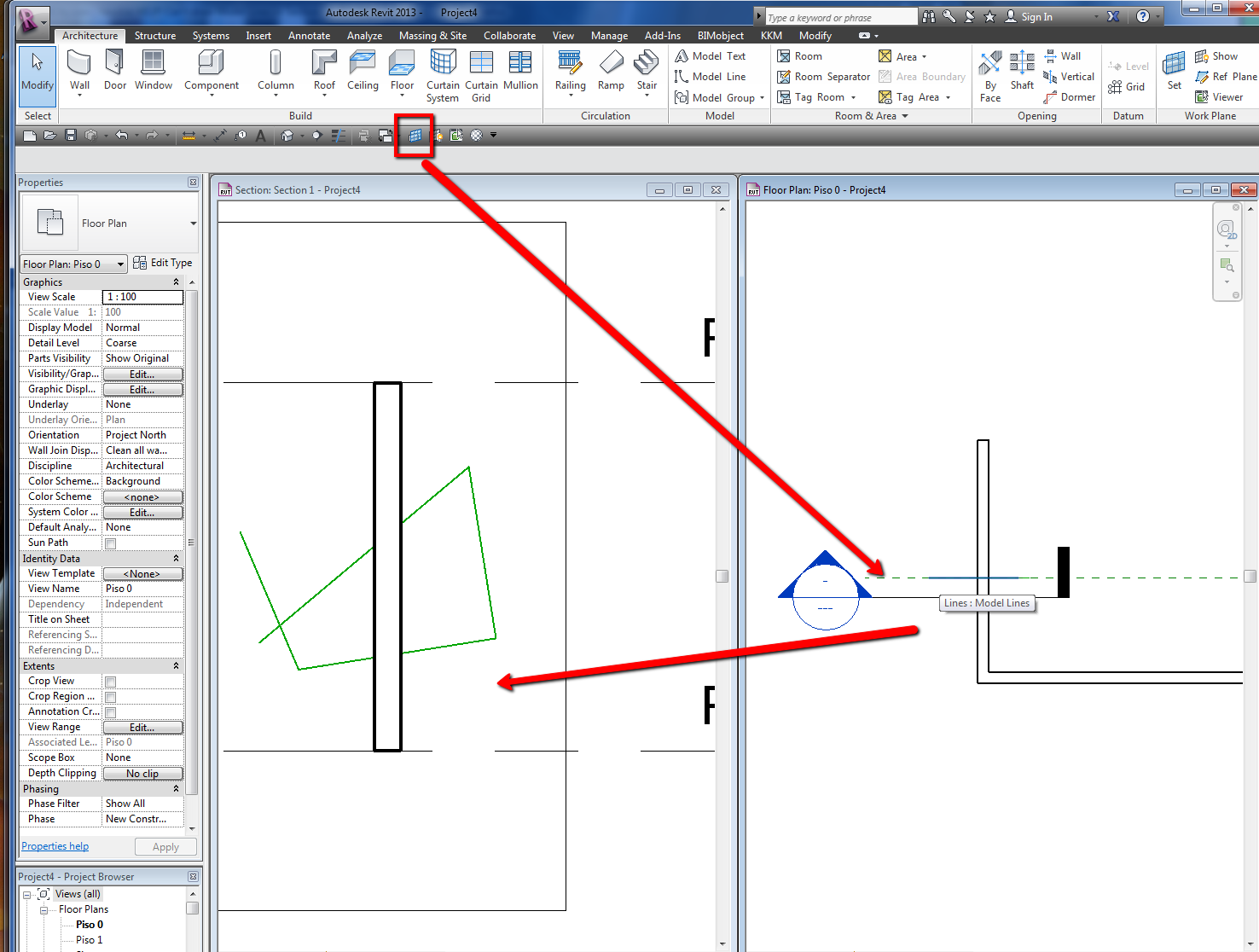

First select the "Workplane" then draw the model lines in that section view, in plan view create a "ref. plane" near the place you want your model lines, select "set work plane" and select that ref. plane, open that section view and draw the model lines.

I get it. So I pick the plane on the plan and then work on the section or elevation. I was trying to select the plane IN the section. Thanks for the clarification. I knew it was going to be something simple. Thanks.
