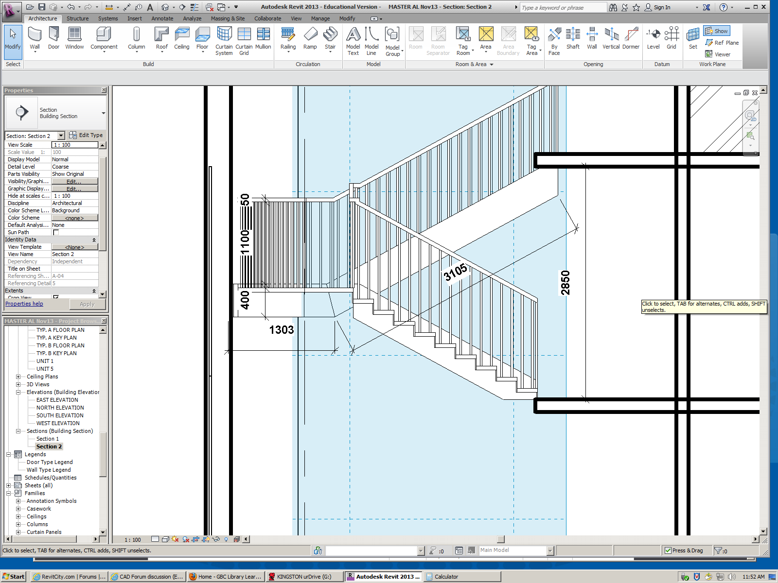

Hello everybody,
was wondering how to get stairs to be level with my floor slabs...I was told that the calculation in figuring out your total number of risers is floor to floor height (which in my case is 3m) divided by the riser height..so I got my riser amount but the stairs are not flush with my floors...I've provided a print screen so you can see what I'm talking about.
Cheers,
-GC

Is it because you have the 'Starts with riser' and 'End with riser' turned on ? When I look at your image it appears to be doing what it is supposed to be doing.
