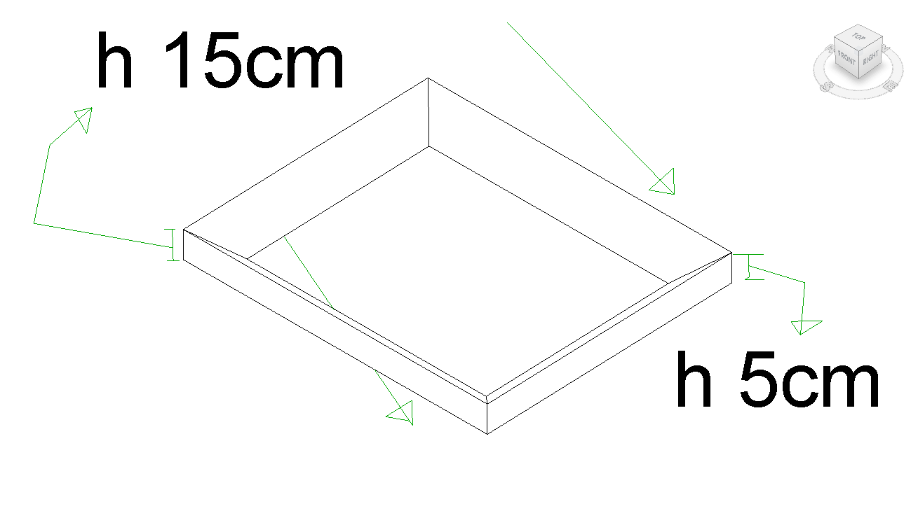

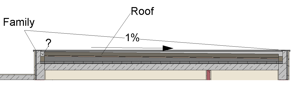

i am tying to do a roof and seems tha i have a problem that i cant solve.
I did this roof with a family and a roof tile, you can see on my foto..
the problem is that my roof has a slope of 1% ,and at every side of the roof i need to make a triangle mortar, (on the photo i have set a question mark.)
i was trying to do this in the family with a sweep. but the only thing i could do was to set this triangle at the 4 sides of the roof with the same height.
I need tha this sweep changes its heigt at every site of the roof inorder to follow the 1% of slope
is there any way to be done?

i thing you didnt understand me
i mean i wanna do this thing
at one site the tringle has to have a height of 15cm and a the south site for example 5cm

That image is more clear than the other, you have to create that in four pieces with In-place > SWEPT BLEND (two profiles), you'll have to use VOIDS to cut the corners.

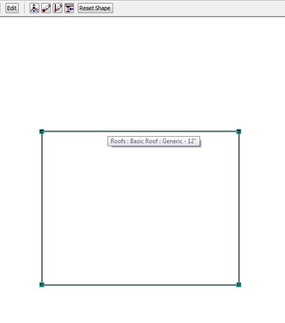

Have you tried with Roof modelling. Select the roof and see in options bar.

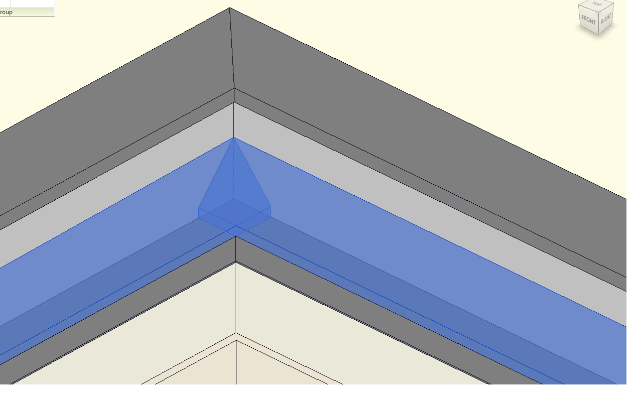

with the roof modeling i cant really do what i whant to build Sad
I used to swept blends with difrent heighs and come to this thing
how can i connect them at the corners?
thanks...

Try Join Geometry

it seems to work
thanks a lot people Smile
