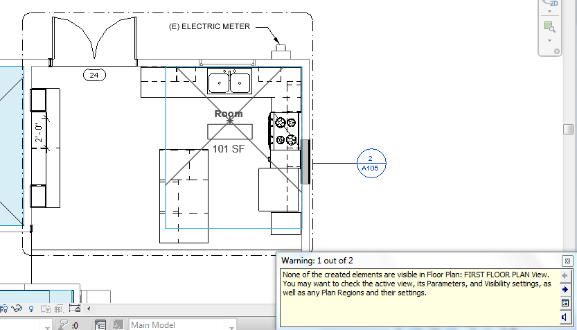

OK.  This should have been a new post.  I'm not working on the same project 4 years later.
When I delete a room there's a notification that says, "A Room was deleted from all model views but still remains in this project. The room can be removed from any schedule or placed back in the model using the Room command."  Why would the programmers assume I want to keep it in the project if I hit delete?
I feel that I've spend 5 hours yesterday reading everything there is on the subject and no one addresses the issue.   As you suggested, I went to the exising demo plan and deleted the rooms.  When I try to add a new room in the same location, I can only tag the old rooms.  I guess if I can't delete a room without it remaining in the project and I can't edit the size of the room... I guess I'll have to fake a room tag with text and a rectangle.

If I turn room bounding off, I cant make a new room.  My goal is to label the whole area shown as a kitchen.

Not placed rooms are rooms that were deleted from the plans.  Up until 11 I think, deleted rooms were completely removed from the file.  Now they remain in the schedule so that you have the opportunity to copy and use them elsewhere.  When they are no longer useful, delete them in the schedule and that completely removes them.
In this post, I explain why Autodesk kept deleted rooms and how to get rid of them: http://www.revitcity.com/forums.php?action=viewthread&thread_id=23170
Here is a post where I describe Revit's Phases: http://www.revitcity.com/forums.php?action=viewthread&thread_id=35001
If you turn off room bounding for an object, it is only for that object.  If your room is no longer enclosed, then what was supposed to bound it?   You must have a room bounding element - a wall or a room bounding line.
Rooms and phases are very unique and hard to understand.  Here is a thread where I show how to have existing rooms tagged in a plan.   No dummy tag needed. http://www.revitcity.com/forums.php?action=viewthread&thread_id=32322&start=15
