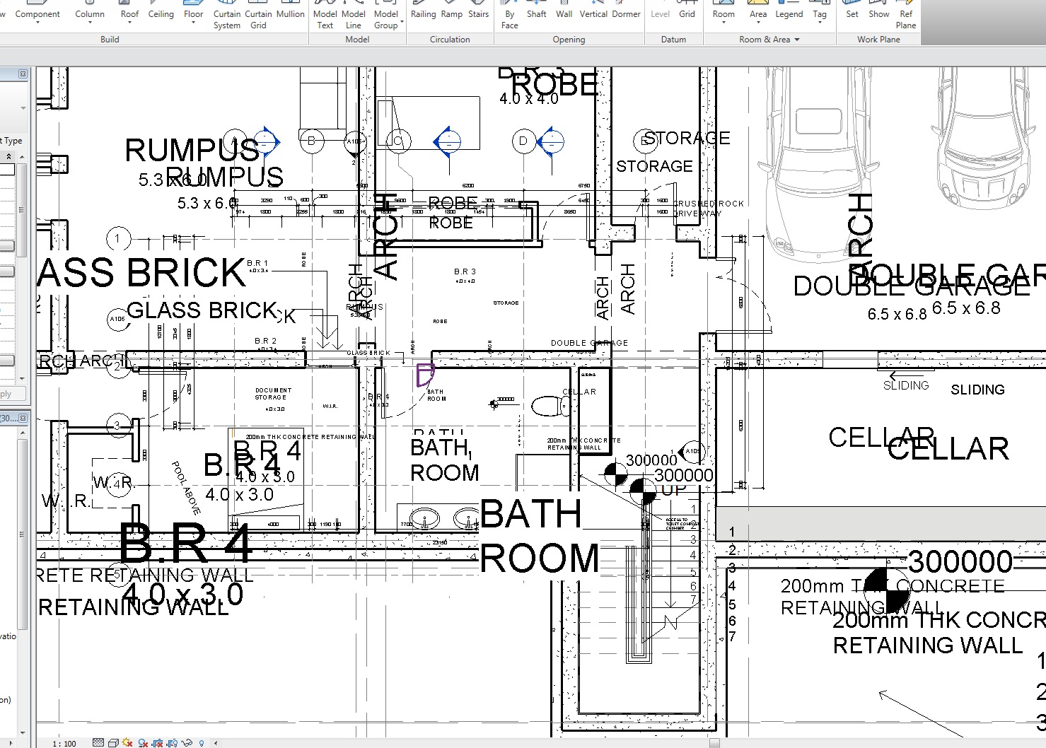

I experience some zoom issues with the following troubles
When I zoom in with the mouse wheel and release the wheel and hover
with the cursor over the drawing all dimensioning and text seam to
double up, and no items cant be picked as normal with the snaps .
Hope this make sense

It seams a graphic card issue, try to update your GC drivers and in your Options turn off "hardware acceleration"

I've had the same issue on two machines. Whats a bit freaky is I haven't seen that issue before and its happened on the same day. Yesterday I changed the drivers on two of the machines to the revit certified driver and it solved the problem. Only to happen again today after the computers had been restarted. Any help would be much appreceated
