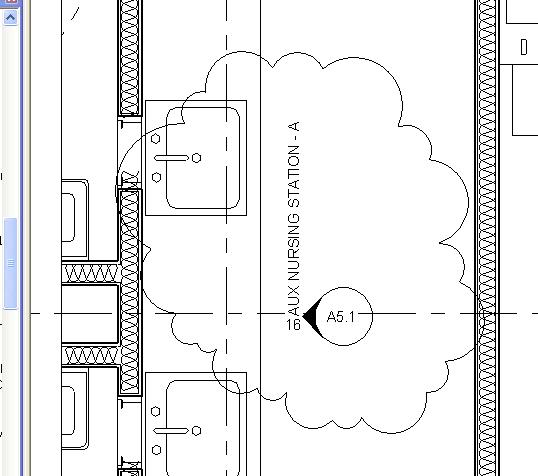

How do I edit the elevation symbol to simply show the detail number (in this case, "16) on the plan without also show the view title? I've tried to turn off "View Title" in the visibility, but this does not seem to work. I cannot find the elevation symbol family to edit because I used the REVIT 8.1 button. Can anyone help? I've attached images showing the problem. Post edited on 2006-01-19 13:47:20

Go to Settings... View tags... Elevations Tags... and UNCHECK Show View Name
