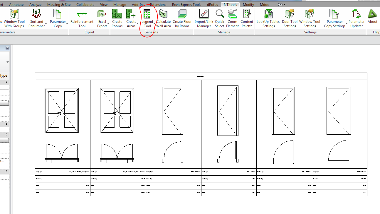

Sofus
Joined: Mon, Nov 12, 2007
19 Posts
1 Stars: 1 Votes
The company I work for has developed a tool to set up legends with a layout template, so Legend components are included in a automaticly generated element-type-legend. Our homepage is in danish (nti.dk), its a scandinavian Autodesk reseller, but the tool is in english. I can help if you are interested, or maybe someone has developed something similar in Autodesk exchange.
