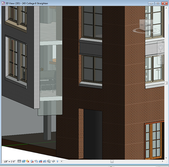

At Home>Opening tab>Wall in Revit 2012 I cut an opening in a brick rainscreen wall and the brick coursing turned vertical at the wraps. Does anyone know why this happened or have a solution?
Mon, Nov 19, 2012 at 7:38:34 AM | Brick Coursing Changing to Vertical At Wall Opening
Not sure why it happened.  Did you have to rotate the pattern on your walls because they were also vertical?  If so then it is your brick definition.
The solution is that you now have to rotate the pattern on each of these walls. ... You could try painting it on again.  Either way, this would be a pain.

In case anyone else runs into this, I discovered the solution. I used Home>Opening>Wall to create the openings that caused the vertical brick. When I deleted this and used Edit Profile the problem was solved and the brick is now wrapping as one would expect.
