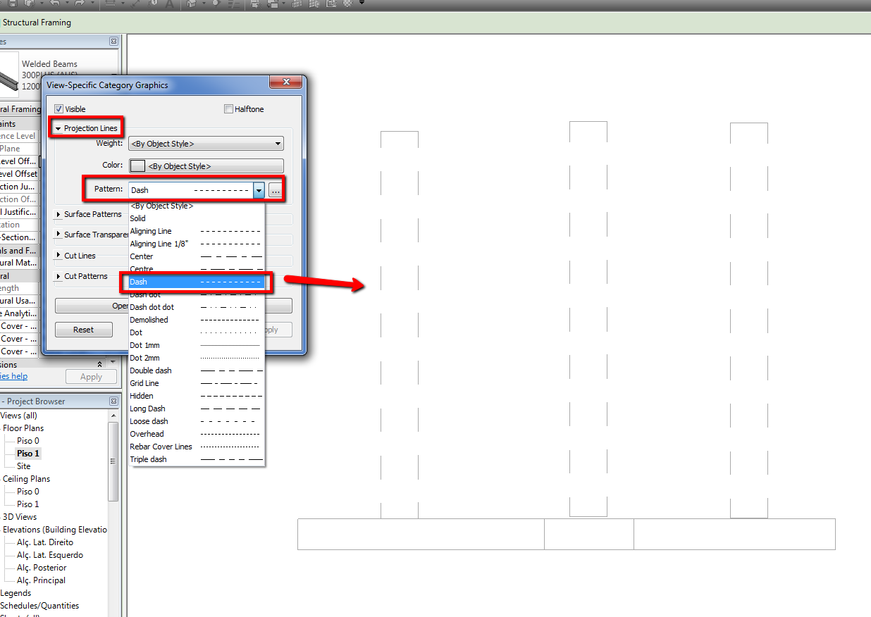

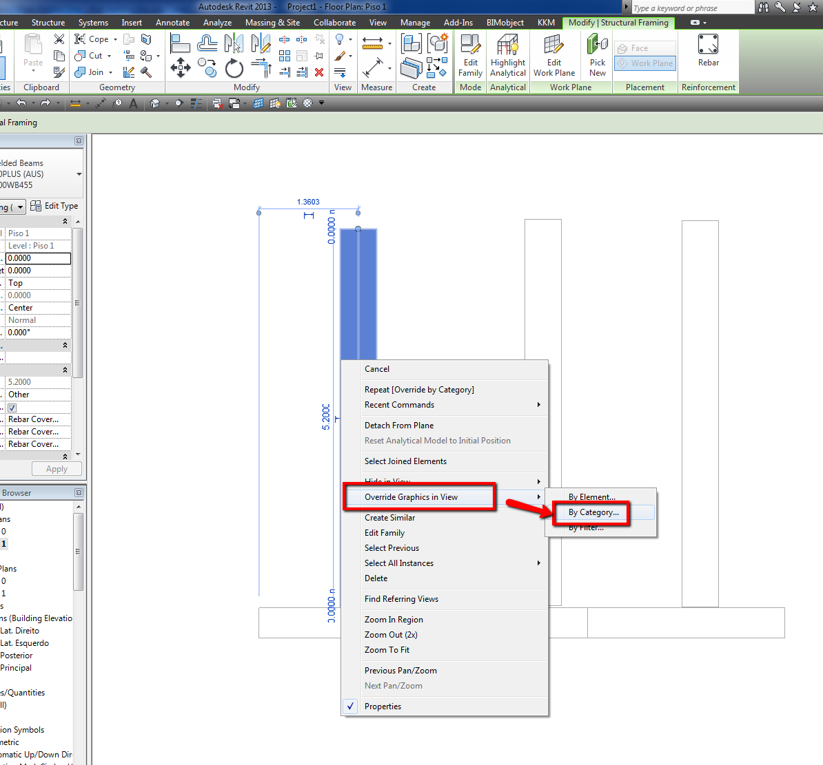

Try to "Override Graphics in View" by "category"

oops.. this one too

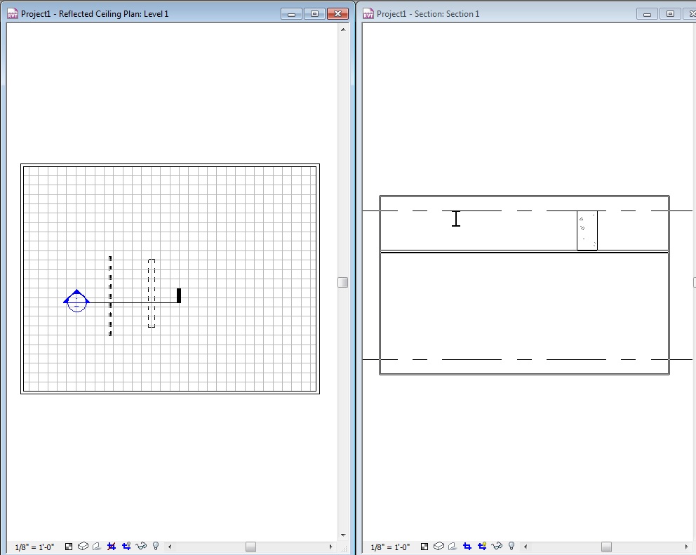

I don't have any problem with both the beams. Check the attached image.
What is the length of your W-Wide Flange beams, may be scale problem.
Post some images for more clarity.
