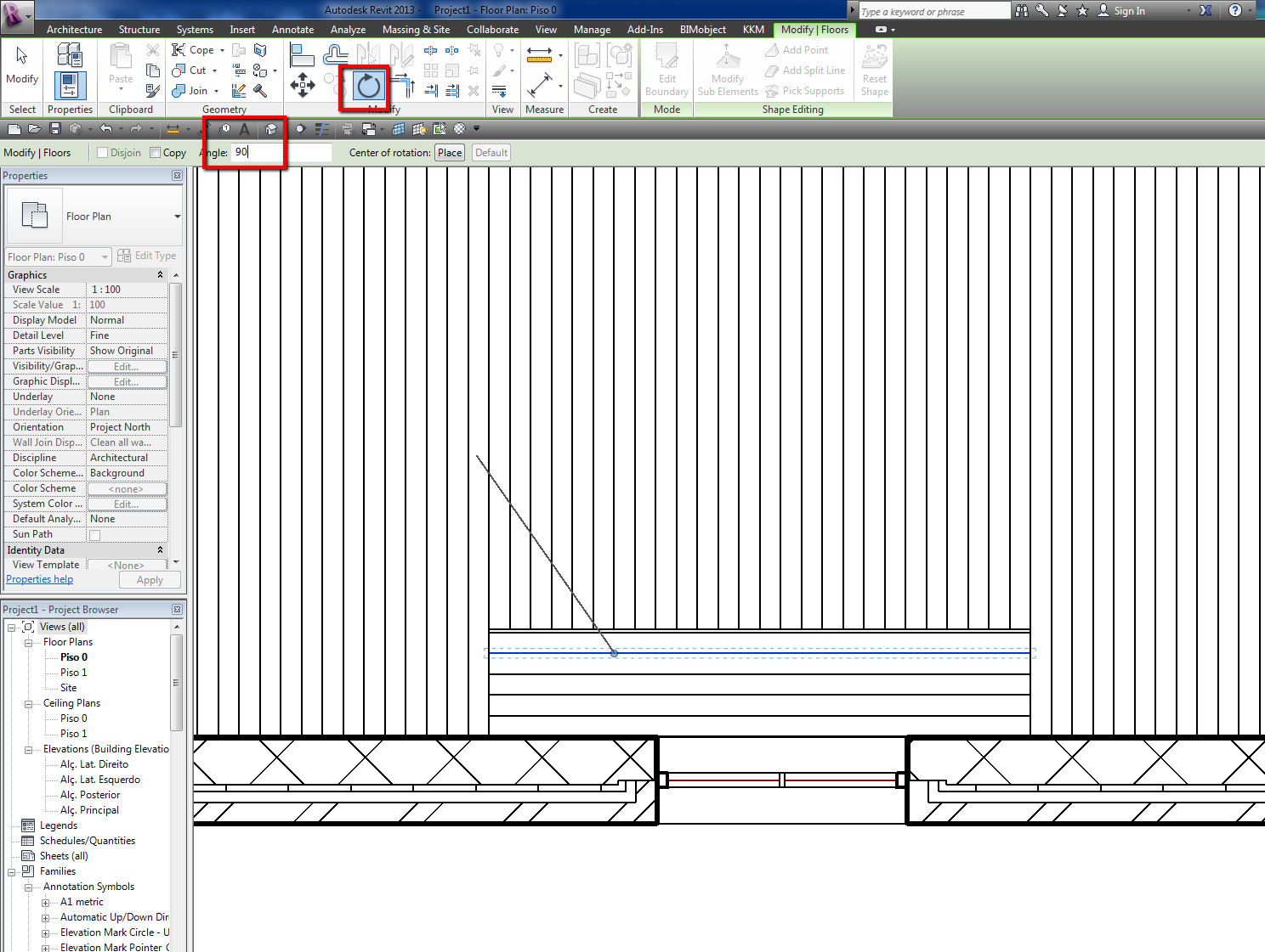

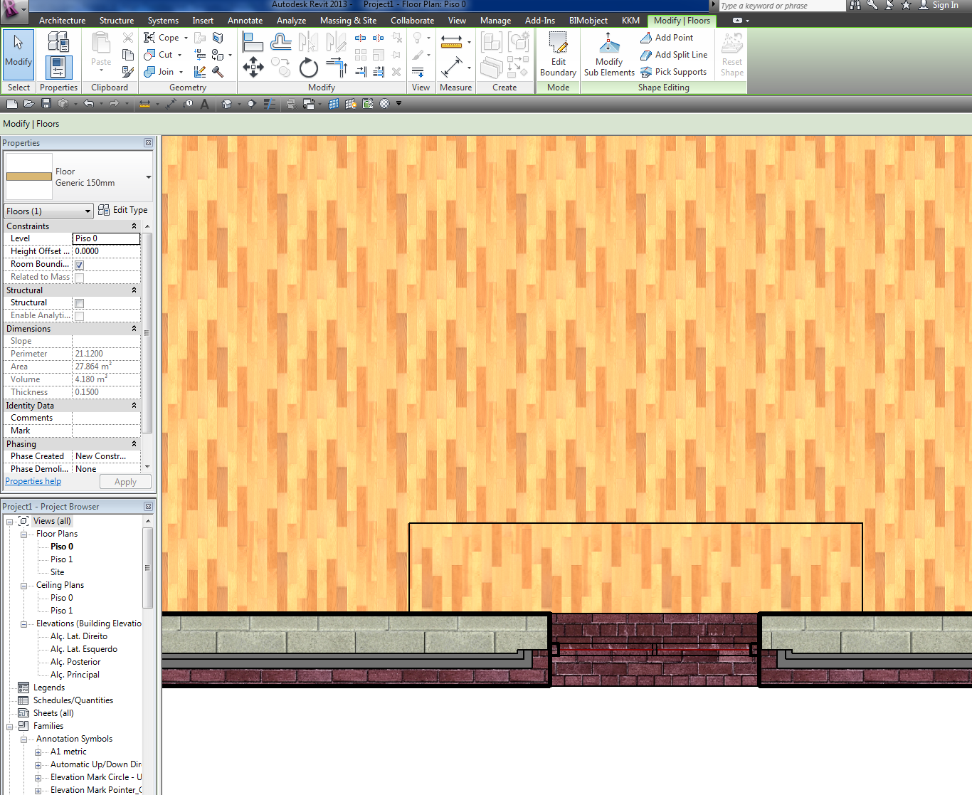

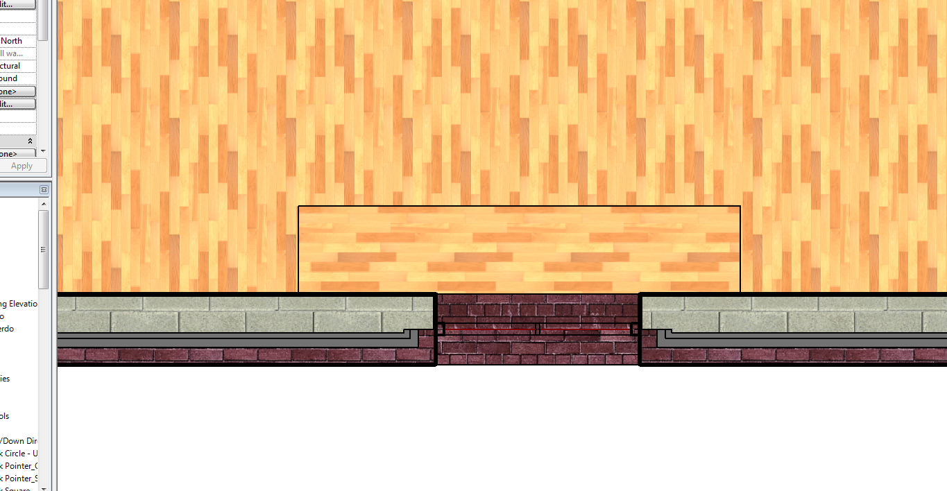

Hi
I have this little problem: http://img72.imageshack.us/img72/1456/revittextureproblem.jpg
How can I rotate the window texture (created with split face and paintbucket) so it align perfectly with the rest of the floo, without creating another material ??
Sun, Nov 18, 2012 at 5:15:00 AM | Rotate 'n' Align Paintbucket Textures
Joined: Tue, May 22, 2007
5921 Posts
4 Stars: 205 Votes

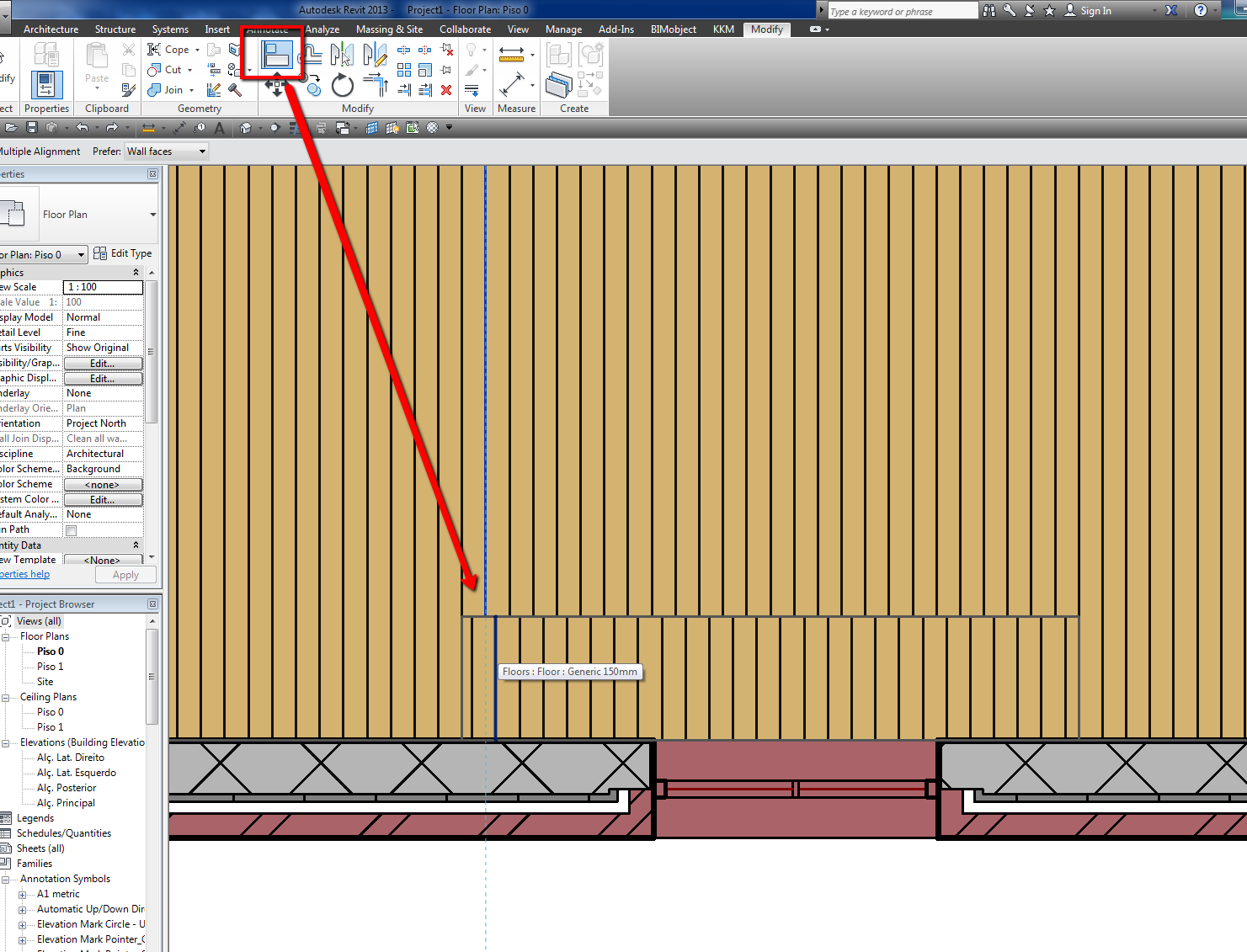

If you have a "Model" Pattern just rotate it then use the "Align" tool to align.
Sun, Nov 18, 2012 at 6:39:30 AM | Rotate 'n' Align Paintbucket Textures
thebearbj
Joined: Thu, Aug 30, 2012
2 Posts
Thank you ! Exactly what I was looking for Smile I'll hope they next time create a function where you just can rotate the material without creating a surface pattern :O
