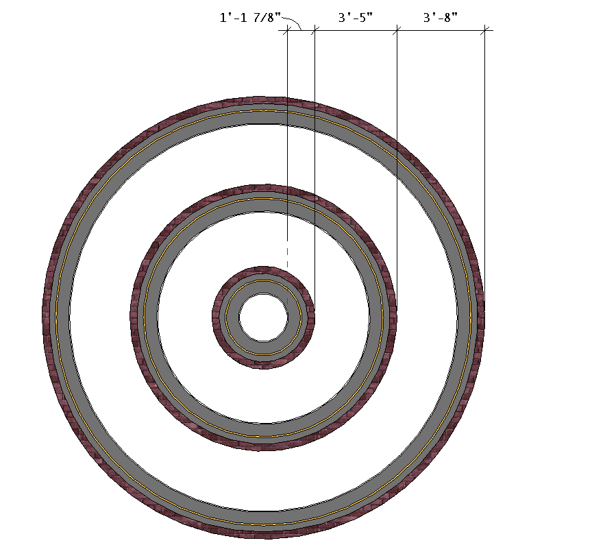

If I understand your question right you can add a reference line to where you want to start dimensioning from then revit will let you pick the walls from face to face.  If I'm missing your point please add a picture to explain further what you are trying to accomplish
Fri, Nov 16, 2012 at 2:06:01 PM | Dimensioning Concentric Circles...? Revit Arch 2012
arusso5
Joined: Mon, Aug 10, 2009
97 Posts
Teafoe, thanks but not what I meant.  From your image, I'm looking for a string of dimensions from the Centerpoint to each part all the way to the exterior most layer.

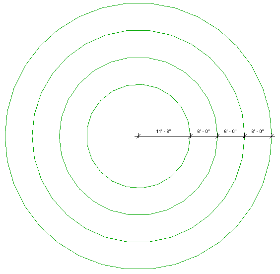

Draw a line alog what you want to dimension - from the center all the way out.  That will give you intersections to dimension to.  If you don't like the line, break it up so you just have small pieces crossing your circles.

Is this what you meam?
