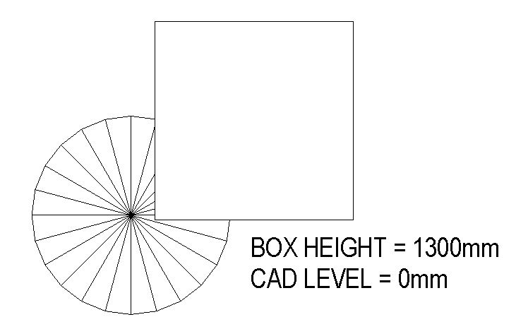

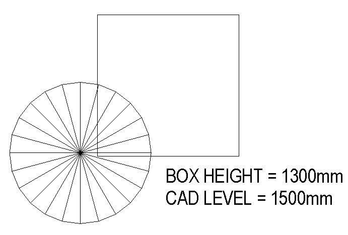

Through my experience, you found Background and Foreground options, that mean, when you insert the CAD file (either link or import), you tick the 'Current View Only' option on left side below the 'bookmark folder'. By ticking that option, you can only have option to put the CAD file as background or foreground.
If you insert the CAF file without tick that 'Current view only' option, you should notice the 'Place at' list down below above open or cancel button.. After you insert the CAD, now you will have the ability to specify the level of your CAD drawing.. So.. if your building is 4000mm tall from Level, and you specify your CAD at 2000mm above Level, then that CAD will still be covered by the building.
Attached is the example.. the CAD drawing is the circle and the rectangle is a 3D box family I assume as the building, created in Revit..
