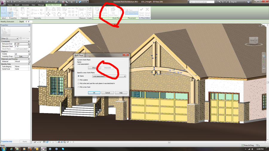

The component may be constrained to the plane it was created on. Click on the model, then edit in-place >> click on all the individual elements within the component >> edit Work Plane >> Under 'Current Work Plane' click Dissociate. That will stop it from being constrained to the plane it was created in, probably the horizonal level you were working on.
There is only one element, [an extrusion], in the component.
I checked and there is no workplane associated to it. You mean here, right: ScreenShot Link

Yes I think this is referring to the same thing. See attached picture.

You should be able to move an in place component in any direction. There is something fishy you must have done while creating it that is constraining it.
Couple of things you could try:
1. Show a screengrab of the sketch used to create the form, that might help others have a better idea of how you built it. It's difficult to know what the problem is just seeing the final product. Or perhaps even load a version so that others can try it.
2. Try building a new component fron scratch, perhaps you did something you didn't realize while building it.
