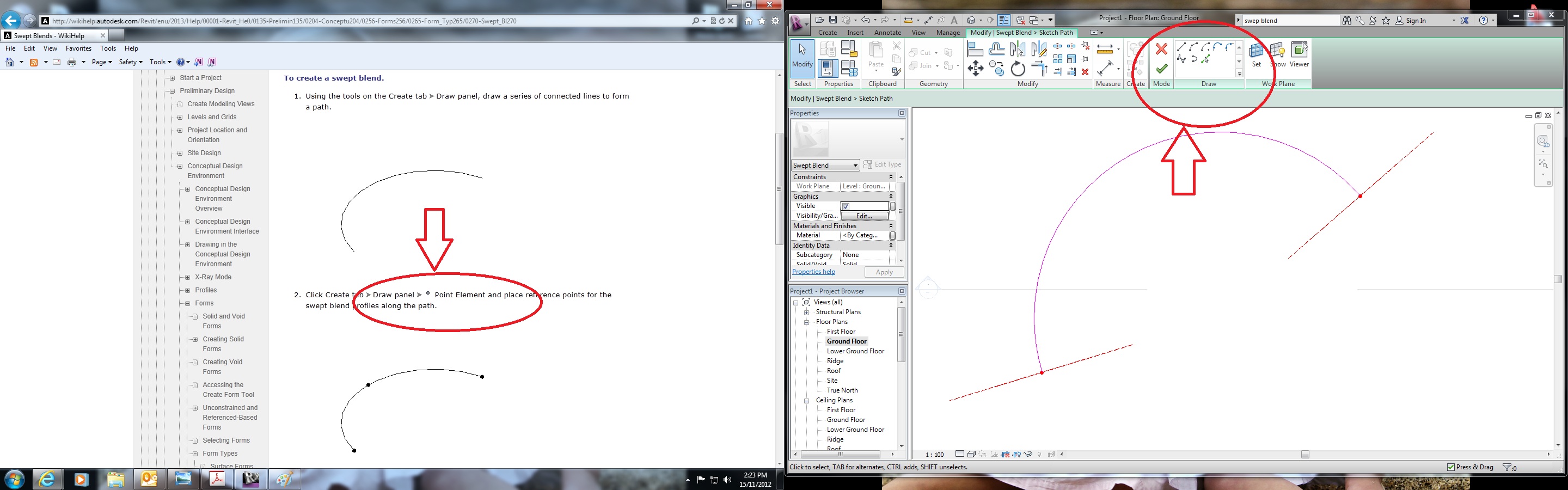

Hi,
I am trying to do a swept blend with 4 profiles and I tried to follow the revit 2013 help. the guide tells me to create the path which i have done and than add point elements. I can't find these "point elements" in my "draw" panel. I attach a sceenshot of my problem and I am sure there is an easy solution to that.
Thanks in advance
Martin

Swept Blend = ONLY 2 Profiles
http://wikihelp.autodesk.com/Revit/enu/2013/Help/00001-Revit_He0/2760-Tools_an2760/2761-Sketchin2761/2785-Creating2785/2797-Creating2797

Thanks Typhoon,
in the wikihelp there is an option for 2 and more profiles, please see attached link. that's what I am tring to do.
http://wikihelp.autodesk.com/Revit/enu/2013/Help/00001-Revit_He0/0135-Prelimin135/0204-Conceptu204/0256-Forms256/0265-Form_Typ265/0270-Swept_Bl270

It is possible, but you are using the wrong tools or environment. The sample in Wikihelp refers to a family that uses the options that are available in the generic adaptive template, the mass template, or the in-place mass tool. By your illustration, it seems that you started with the in-place component tool, which does not have the reference points option.

Thanks alfmedina,
that was the problem. It just makes no sense to me why I can't use it in the in-place component tool.
