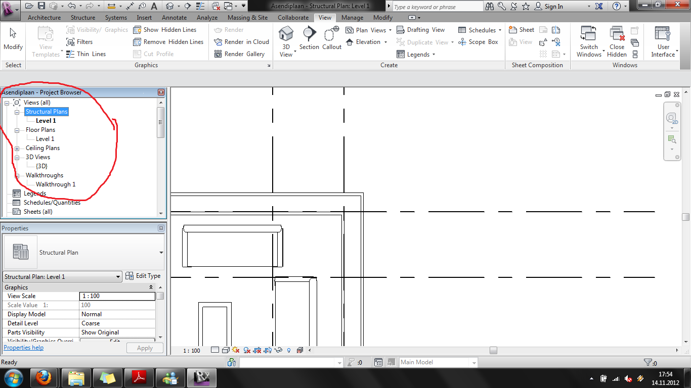

It should be very easy, but I just can't figure out how to view only foundation plan/view.. Problem is, that I made foundations hosted by walls and now I can only see them in "structural plan - level 1" within the walls, but I would like to see only footings, not with walls.. Shouldn't there be a special "foundation level" or smth in the views panel? Any help is welcome!
Thanks

If you have a level called foundation then from your view tab, create a plan of that level.  If you don't, then you can create the level and then make the plan.  Set your view range accordingly.
Also, you can copy the floor plan, change the view range, call it a foundation plan and turn foundations on, walls off.

How do I just copy the floor plan? Like I said, I have only structural plan level 1 where the footing with walls can be seen. I would like to create foundation plan without walls. The question is how?

Fundamentals....
View tab -  / plan views / floor plans / uncheck the do not duplicate box and pick your level.  Set your view range and VG settings.
