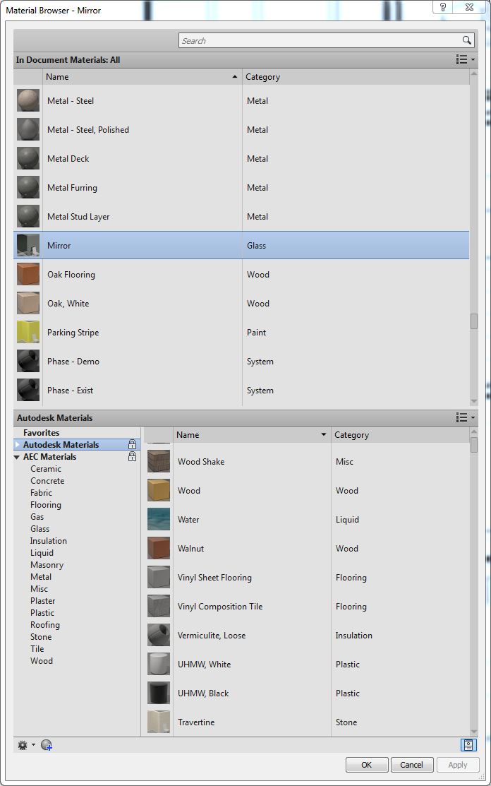

I created a simple extrusion for a mirror. I applied the out of the box mirror material to the extrusion and it does not reflect whatsoever in a rendered view. I've toggled the reflectivity of the material, but there doesnt seem to be anything else that would make this function properly. I've also tried downloading a mirror and it also does not work. What am I missing?

Did you make the mirror as an in-place family?  Make sure that the material is correct in the PROJECT and not just in the family itself

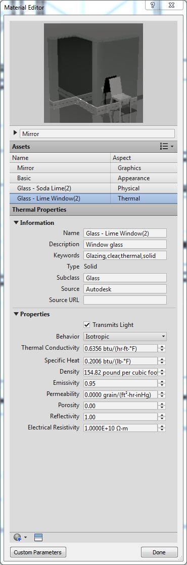

Don't you think 1% reflectivity is a little low?  Try 100
Wed, Nov 14, 2012 at 12:40:37 PM | Mirror Material in Revit not Working
crwinchester
crwinchester Avatar
Joined: Sat, Sep 4, 2010
173 Posts
3.5 Stars: 6 Votes
I tried that setting. The values can only be set from 0.00 - 1.00. I've tried both extremes and still no reflections.
Wed, Nov 14, 2012 at 1:27:09 PM | Mirror Material in Revit not Working
OK, I see now that they changed this setting values in 2013.
I did a quick test and the stock mirror works just fine so something else wrong in your model or process.

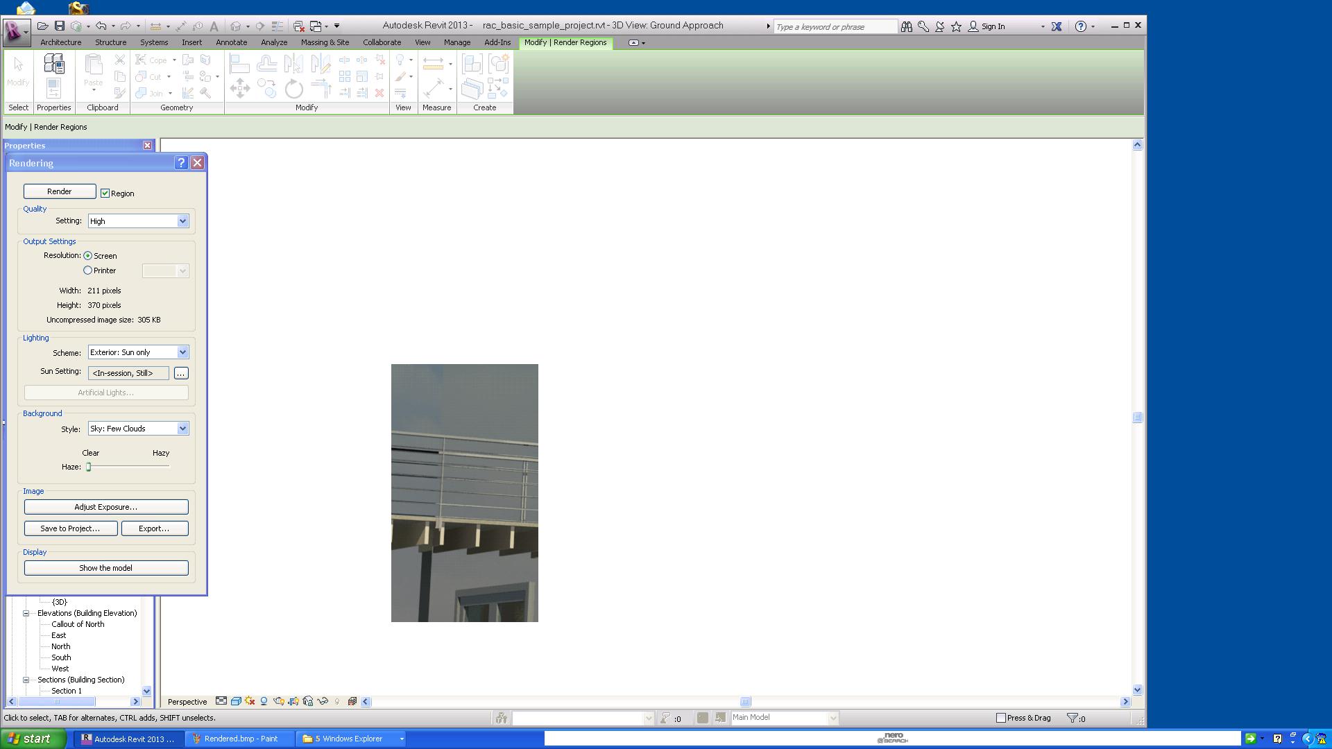

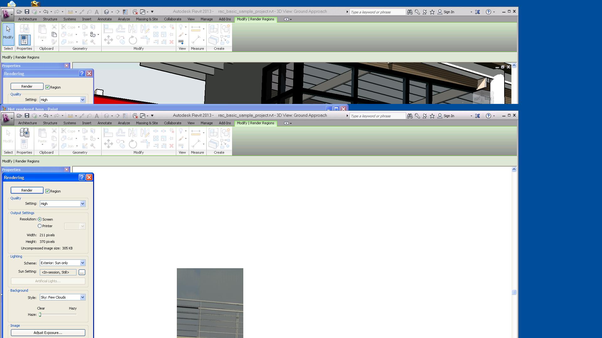

#9
I just used the built in mirror material.
Better image ... you can jst barely see the edge of the mirror material
