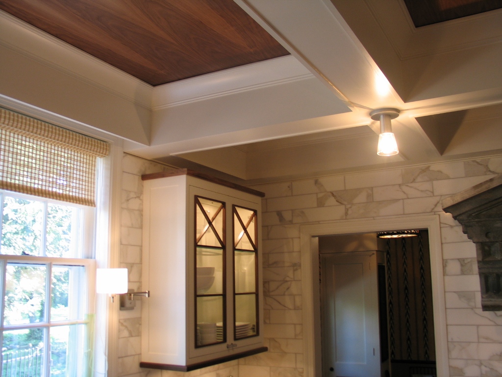

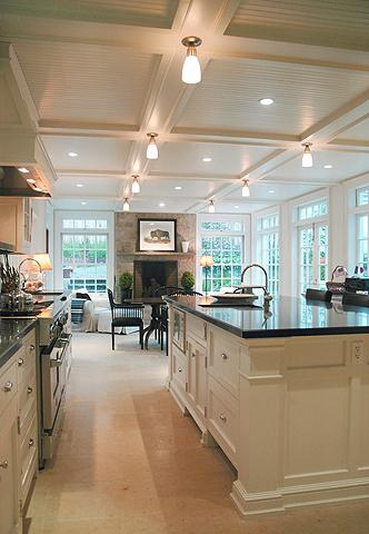

Hello, Can somone describe or point me in the right direction as to how do I create a coffered ceiling in  a kitchen. I have
some examples I would like to create, and I need to put lighting in the ceiling.
113231_Decorators-Showhouse-Kitchen-Coffered-Ceiling.jpg113231_whitecofferedceilings.jpg

I would just do this as an in-place family.. maybe a sweep so you could get a more detailed profile or just a plain extrusion if you are looking for a plain beam type look.
