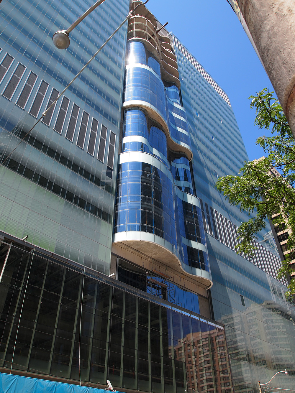

A good start might to take a Generic 6" Wall>Edit Type>Edit Structure>Change Material to Glass>Change Thickness to 1">OK Ok ok. Now you have a glass wall type that you can curve to your heart's content. Attached is a picture of the Sick Kids Foundation under construction here in Toronto showing some nice use of curved glass.
