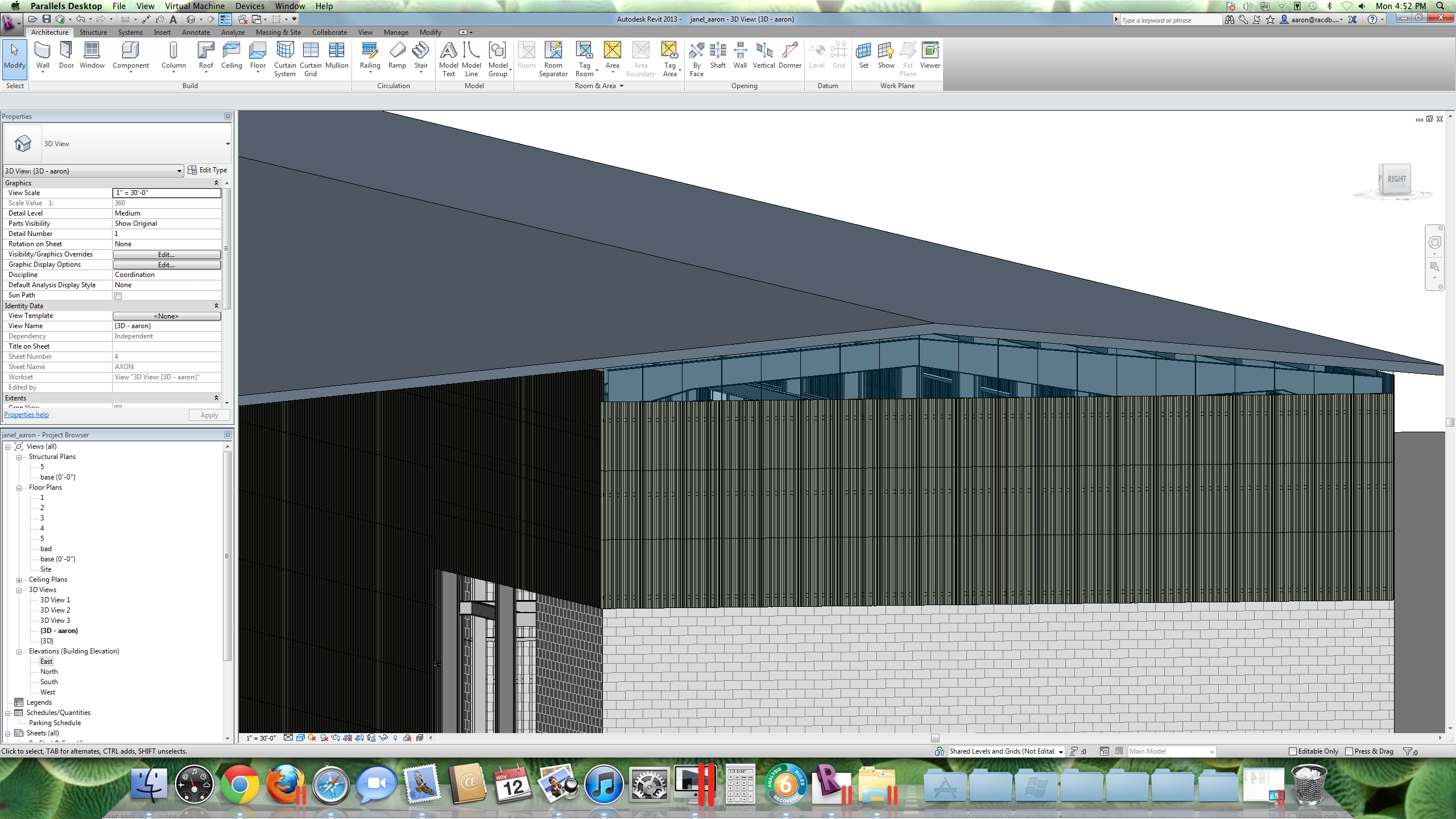

Im doing existing conditions of a factory and when I use a corrigated curtain panel I got from RC I have problems with the top condition where i attached it to the roof. I tried editing profile instead and got the same result. It always delets the corrigation and replaces it with glass.
There has to be some way to do a void or something right?

How about making the top and bottom two different walls ? Then join them to get rid of the horizontal line ? Just a thought. This is an odd result. I would have thought the 'edit profile' would have solved the problem.
Also, try it with a different panel instead (something out of the box) to see if it's the panel family you downloaded that is the problem. If it works with the stock panel then you know it's the family you downloaded.
