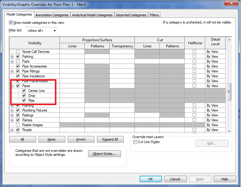

I thought I knew where this option was in 12, but I cant seem to find it in 13.  I would like for the centerlines to be not shown when printing.  By Default, they are supposed to be off, or so I thought.  Any ideas?

Pipe centerline visibility is controlled by the view's visibility graphics as a sub category of Pipes. See attached.
