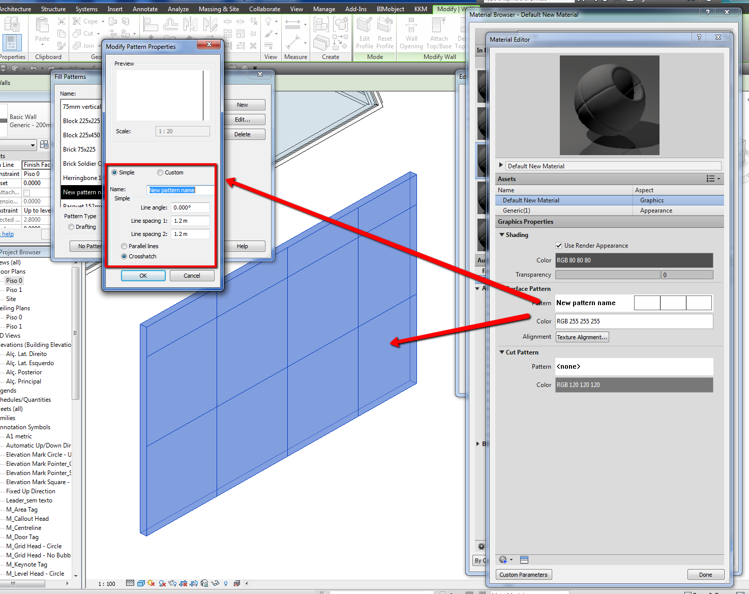

I want to model a house using SIP (Structural Insulation Panels). Creating the wall is easy but I want to show the separate panels as they come in standard sizes of 1200mm wide. I want a line at 1200mm intervals that will depict the join of a panel - it will make it that much easier to model. I tried using a hatch pattern but I can't get it to work. Any ideas how I do this?

Create a "Hatch" for that...

Thanks - such a simple solution - I should have worked this out myself!!!  Sometimes you can't see the wood for the trees ... ha ha
