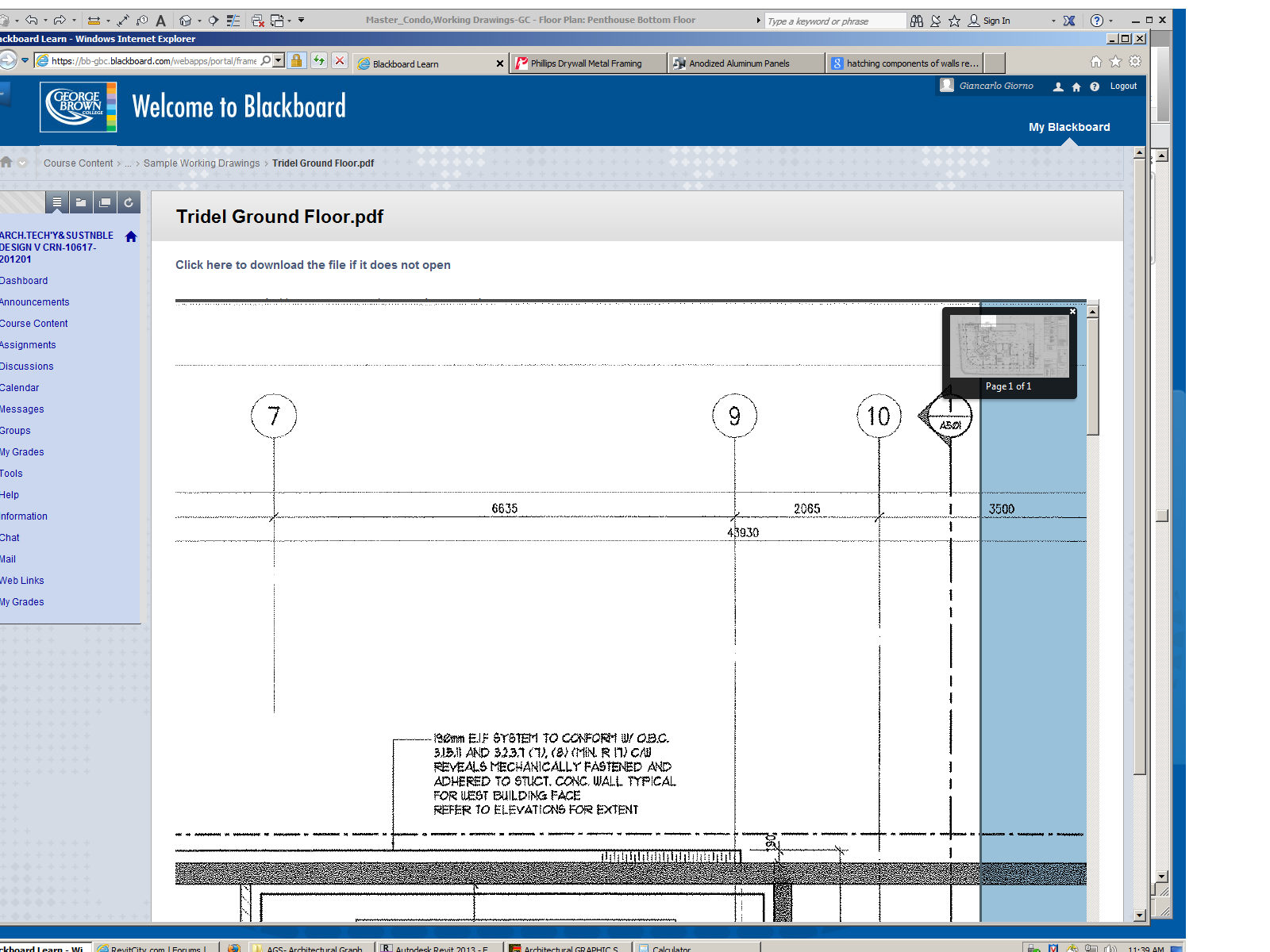

Hello all, I'm trying to show different layers of hatching for my walls in my working drawings. However, revit seems to want to only hatch my walls as a whole. To explain a little better, I have a wall that consists of Anodized Aluminum Panels, Air Barrier, Insulation,Metal Studs etc.. How would I go about only showing hatching for the Rigid Insulation in my wall? Attached is a picture of a Tridel Working Drawing sample. If you scroll down you will notice that there is a wall with E.I.F. attached to a concrete wall that shows hatching for both. Ultimately this is what I'd like to do with different components of my wall section.

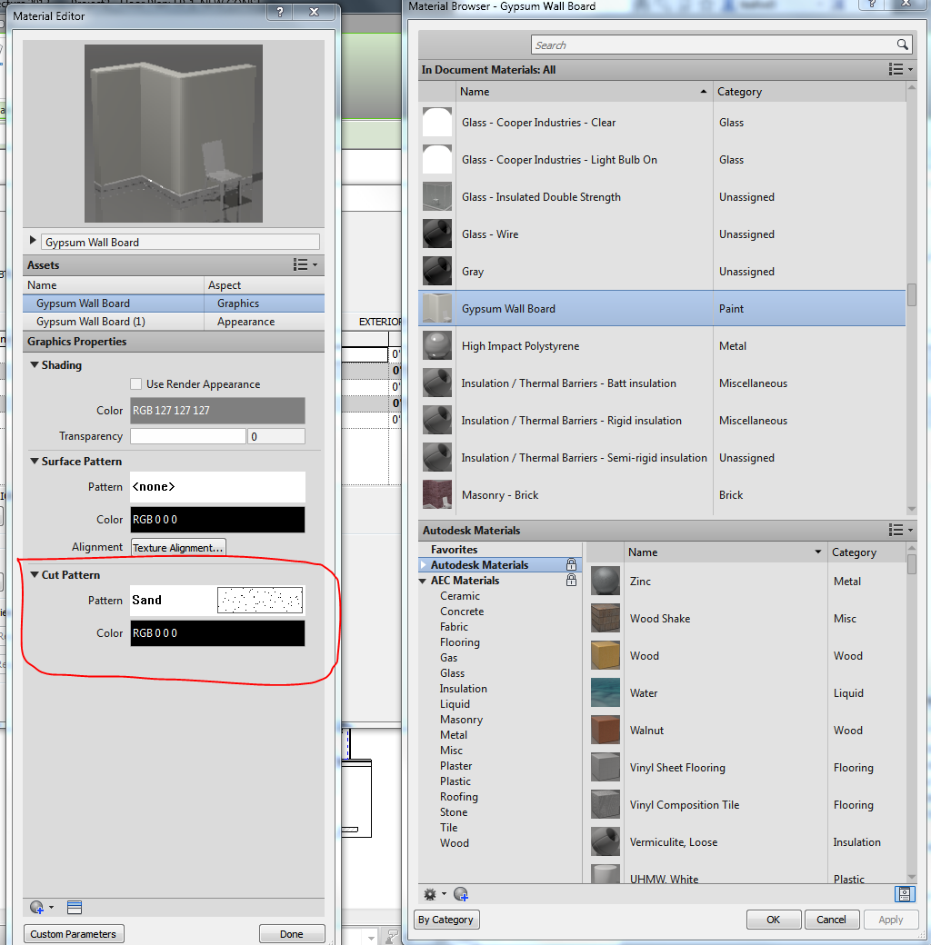

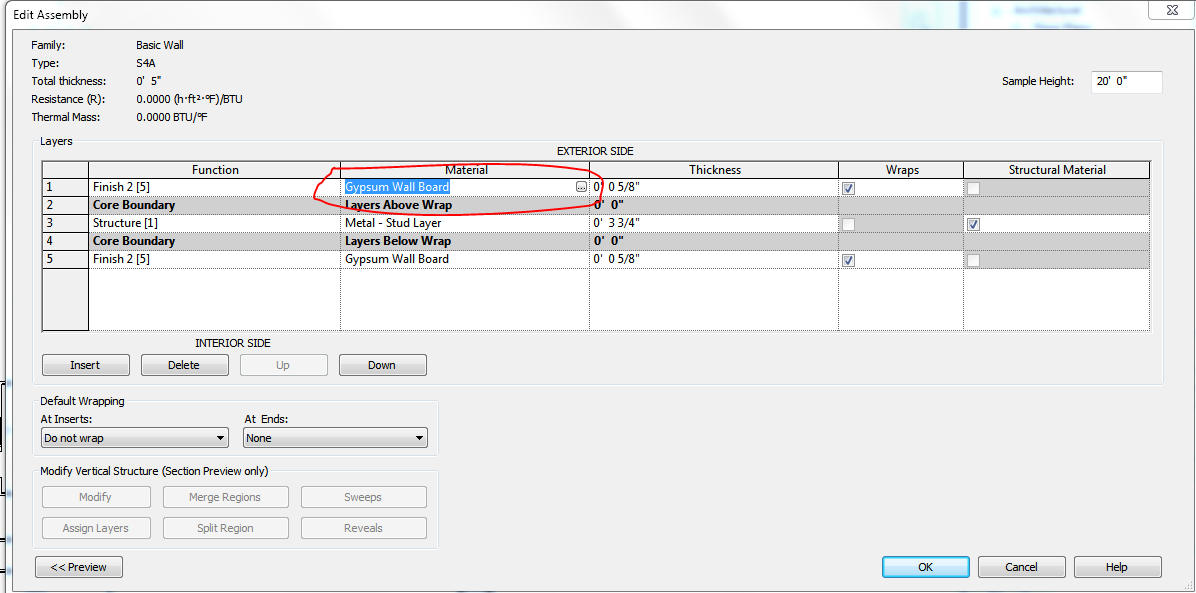

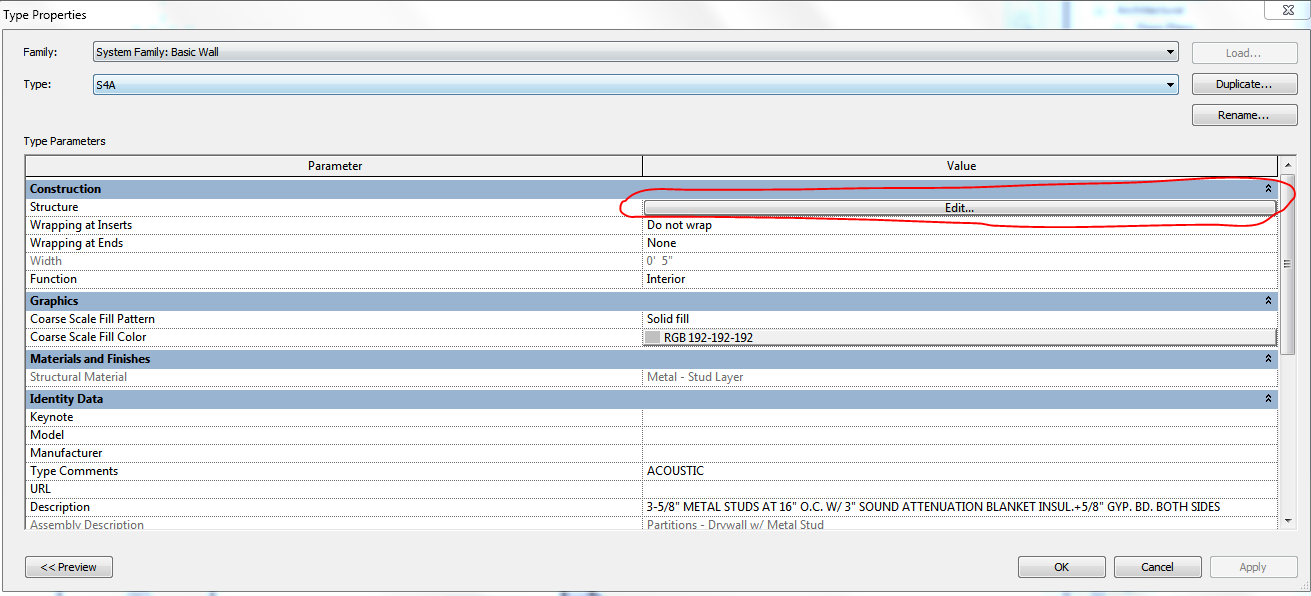

You wall is made up different MATERIALS.  You need to your wall Type Properties> Edit Structure>Edit Material and in your Material Editor change the CUT PATTERN to whatever you want it to be, if you want nothing to show then select NONE
