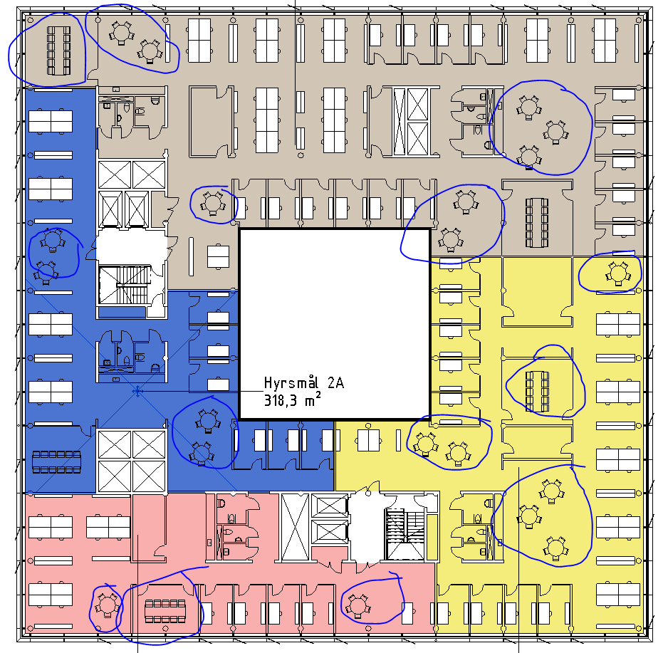

I'm fairly new at revit, and i stumpled upon a little problem. When i color a floor as an area, only the walls and a selected amount of furniture turn white. how can i secure that all furniture are white in plan?
Regards
Petitmaire
p.s
i attached a file showing where the problem is

The "white tables" probably have a masking region in the family.

I think you are right about that. The problem is still that when i edit the family to put i region mask on it, it still turnsout "invisble" in my plan view. I hope you can help with my problem, or refer me to a place where i can find out more about it?
thanks
Wed, Nov 7, 2012 at 7:45:39 AM | Coloring an area, without coloring my furniture?
The family is too low.  Raise it off the floor slightly and see what happens.

I tried to raise it and still nothing happened.. I can make a region on a single table and that works, but i ofc want to add it to the family.. damnit im getting annoyed Puh

choose edit family go to the 3D view.
Select the desktop and click Visibility settings here select the pickbox Plan/RPC.

Okay. I tried selecting and changing the visuability of the table top, and all the check boxes are checked and nothing changed. I am now having trouble copying/moving these particular tables between floors. Have you experience with a family being locked to something instead of the reference floor? (hope this makes sence)
