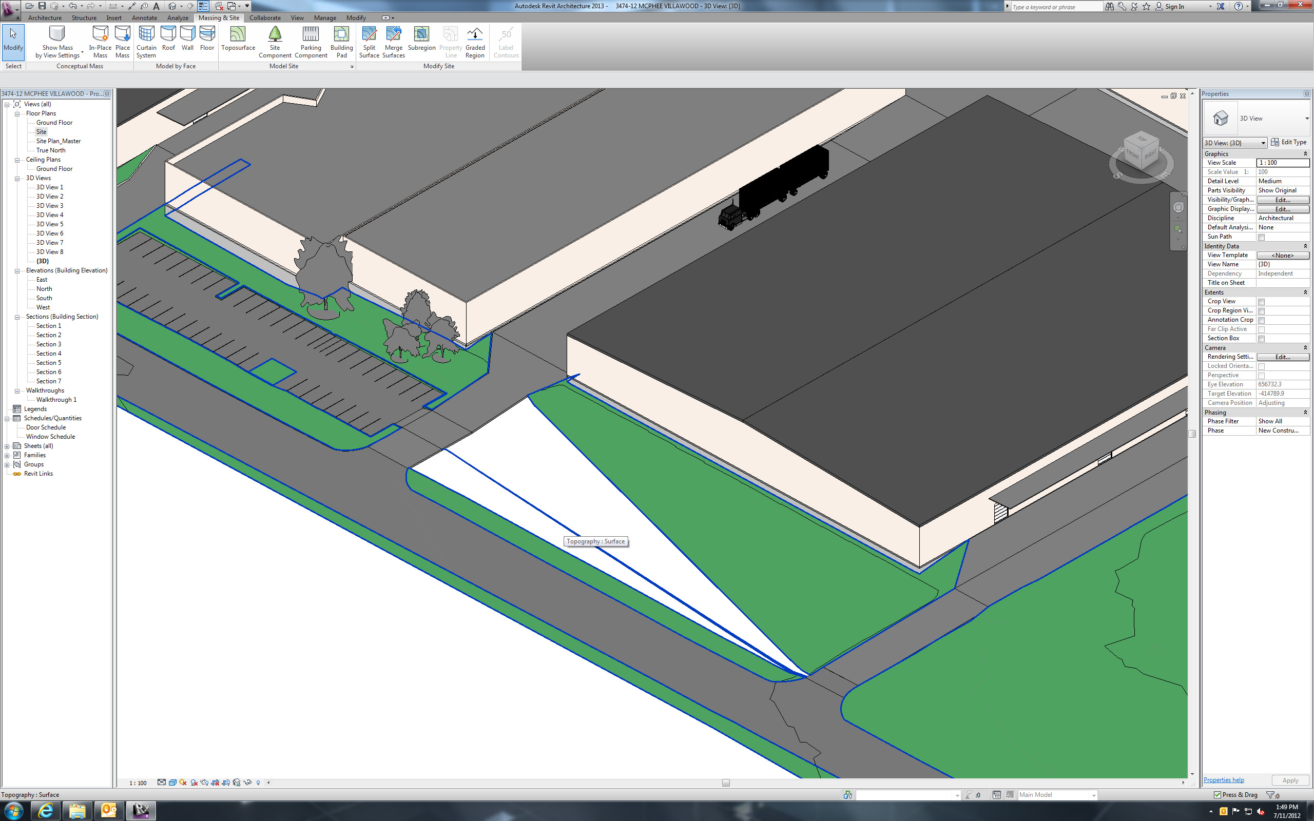

Can anyone help me out, all of a sudden some of my topography has gone missing, i was only adjusting the points to get the topography to meet some building pads.see attached

You might try to break that whole area to several smaller rectangular subregions. That happened to me a lot, to create smaller, simpler subregions always solved my problems.

Thankyou, went with the subregioning option as i couldnt find any other way to fix it, working now, though couldn't put a building pad in their as i wanted, ahwell, only for concept massing exercise SmileThankyou for your help.
