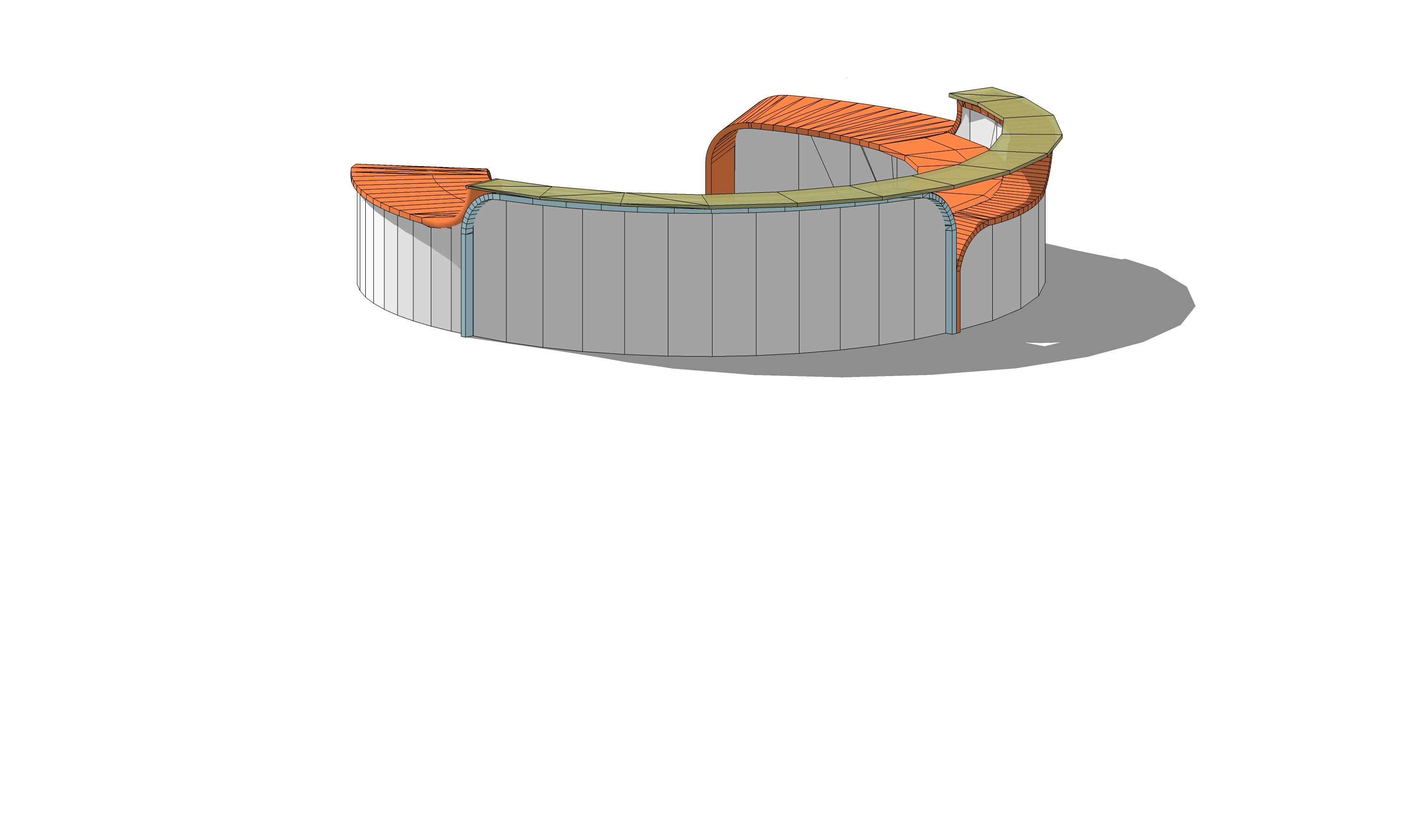

I am attempting to create a reception desk that has multiple curves going in different directions, but am having trouble creating one path in 3D that I can sweep. Is there a good way to do this? I have attached an image of the desk built in sketchup, but would like to build in in Revit so I can edit in here and it will not have as many lines. Any suggestions would be appreciated. Thank you!

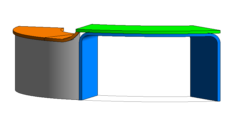

very difficult shape in revit. perhaps massing which I don't use much, or see attached might give you some ideas.

hi
sorry for playing around your reception counter
basically i used all the forms (solid/void) for you to visualize on how to do it inside family editor (generic model>furniture)
hope it helps

is this issue still active? that can be done by sweap, sweap blend and shear effort,.. there are shape that cant be done in a single component,.. devide the shape to a small parts to make it possible.
