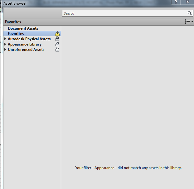

Is anyone having trouble with their Material Editor in Revit Architecture 2013 (besides the fact nobody likes the format)?  It was working fine for me before the update release 2 but since updating with the update release 2 it isn't working right.  I cannot create a new material, the browser isn't population like it should and when I try to add an material to my favorites I get an error saying "Your filter-Appearance-did not match any assets in this library" then if I try to do it again I am unable to click on anything.  I have no clue how to fix this but I cannot create any materials!  Thoughts/comments??

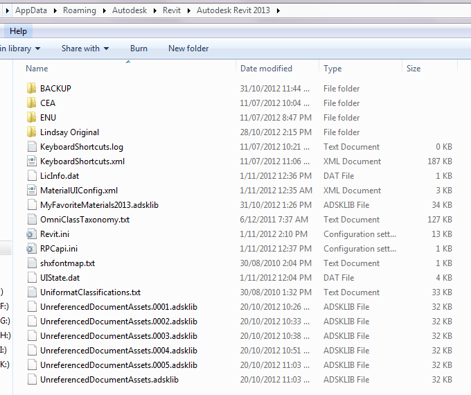

teafoe5:I have had the exact same problem and I have half fixed it in a 'round about way'When the Library has the 'Yellow exclamation mark' ,   Revit cant find it or it is corrupted.They are most probably still there in the folder   ".........AppData \ Roaming \ Autodesk \ Revit \ Autodesk Revit2013""MyFavouriteMaterials2013.adsklib"   and    UnreferencedDocumentsAssets.000?.adsklib"When it happened to me, the "Blue windows waiting circle" remain permanently on.I copied one of the   UnreferencedDocumentsAssets.000?.adsklib"  files and renamed it to "MyFavouriteMaterials2013.adsklib" Then that stopped the yellow exclamation mark and the "permanent blue waiting ring"  but there is still a yellow mark against the "unreferenced documents assets"  but that doesn't seem as important.I had to delete the unnecessary materials out of the Favourites material library.As far as I can tell, Revit/Windows is corrupting the file,  so now I do a daily backup of the all the files in that folder (see above)Since I have waiting a bit longer and opening & closing windows in the Material editor a bit slower, it hasn't happened again.  Still not good enough!
