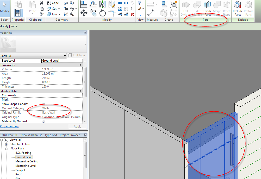

I somehow accidently turned a wall into a part and now Revit identifies it a part redardless if still belongs in wall family. Any ideas how can turn it back into wall?

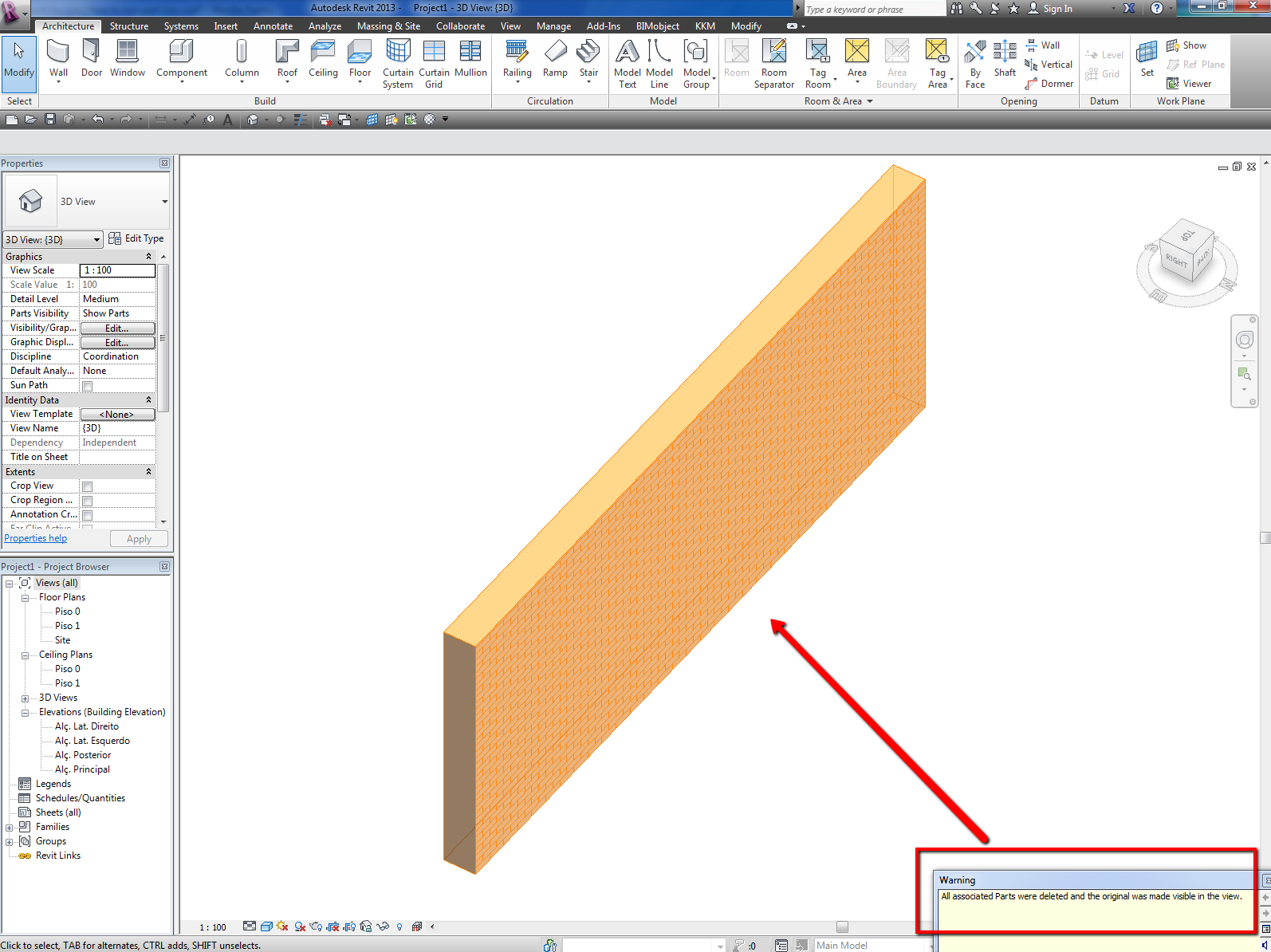

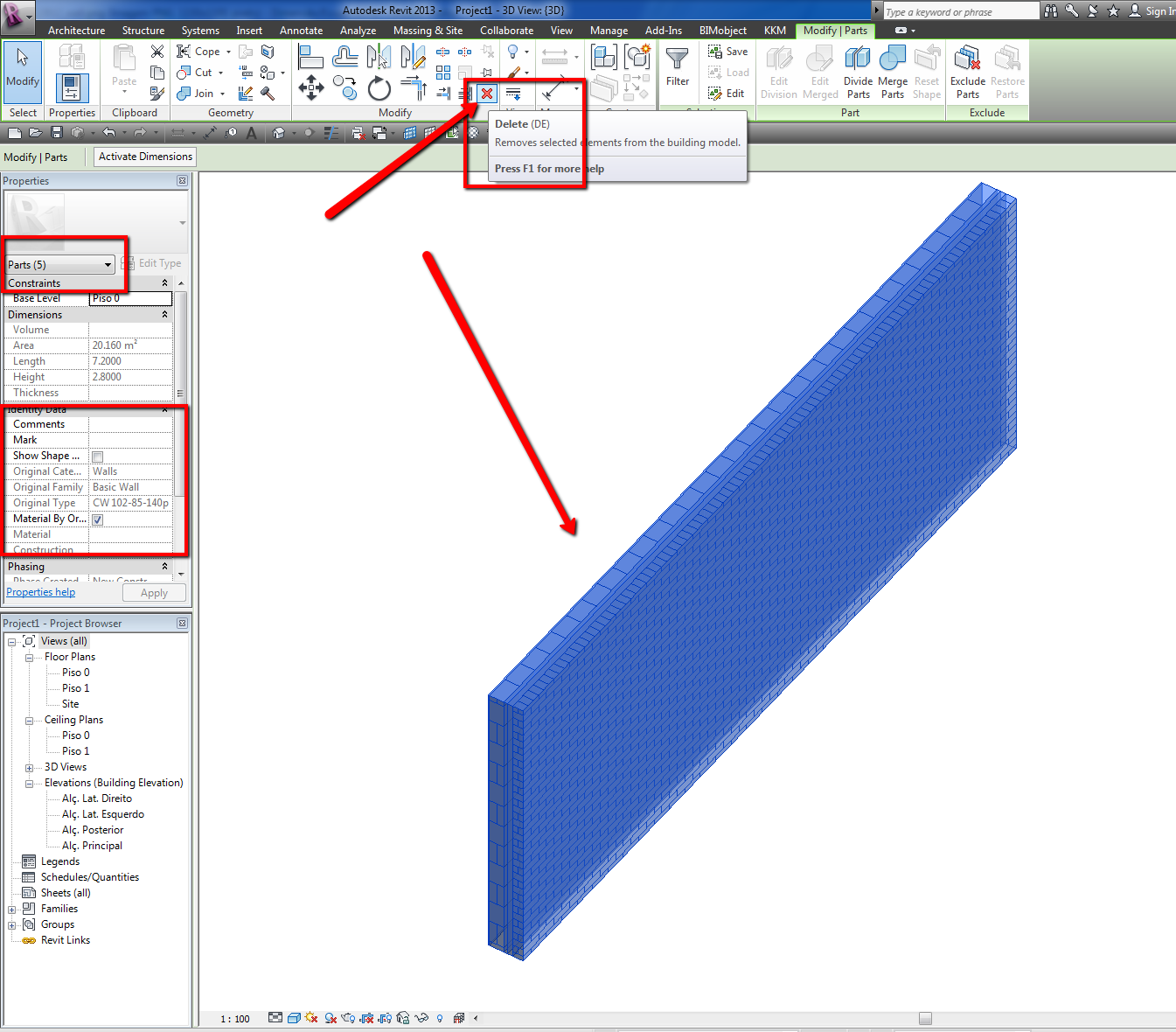

Select that wall by crossing and DELETE

oops... this one too...
