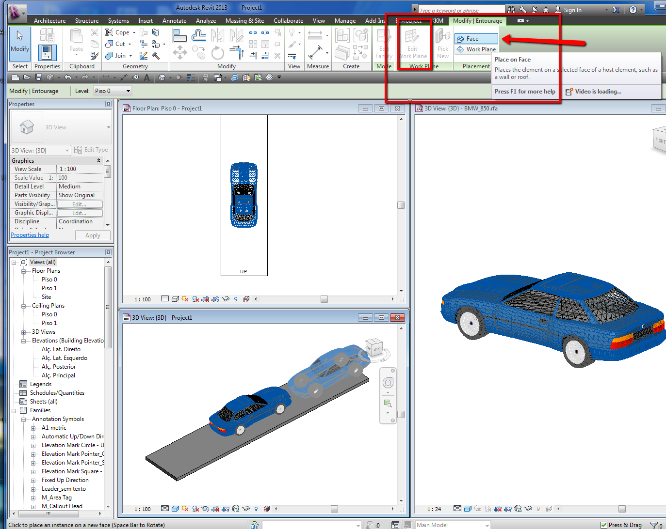

Hi There, anyone can rotate a car in section/elevation? I've tried to edit the family and uncheck 'always vertical' but still not working.  I am trying to put it on a ramp, it works on a floor and pick host but not on a ramp. Thanks in advance!

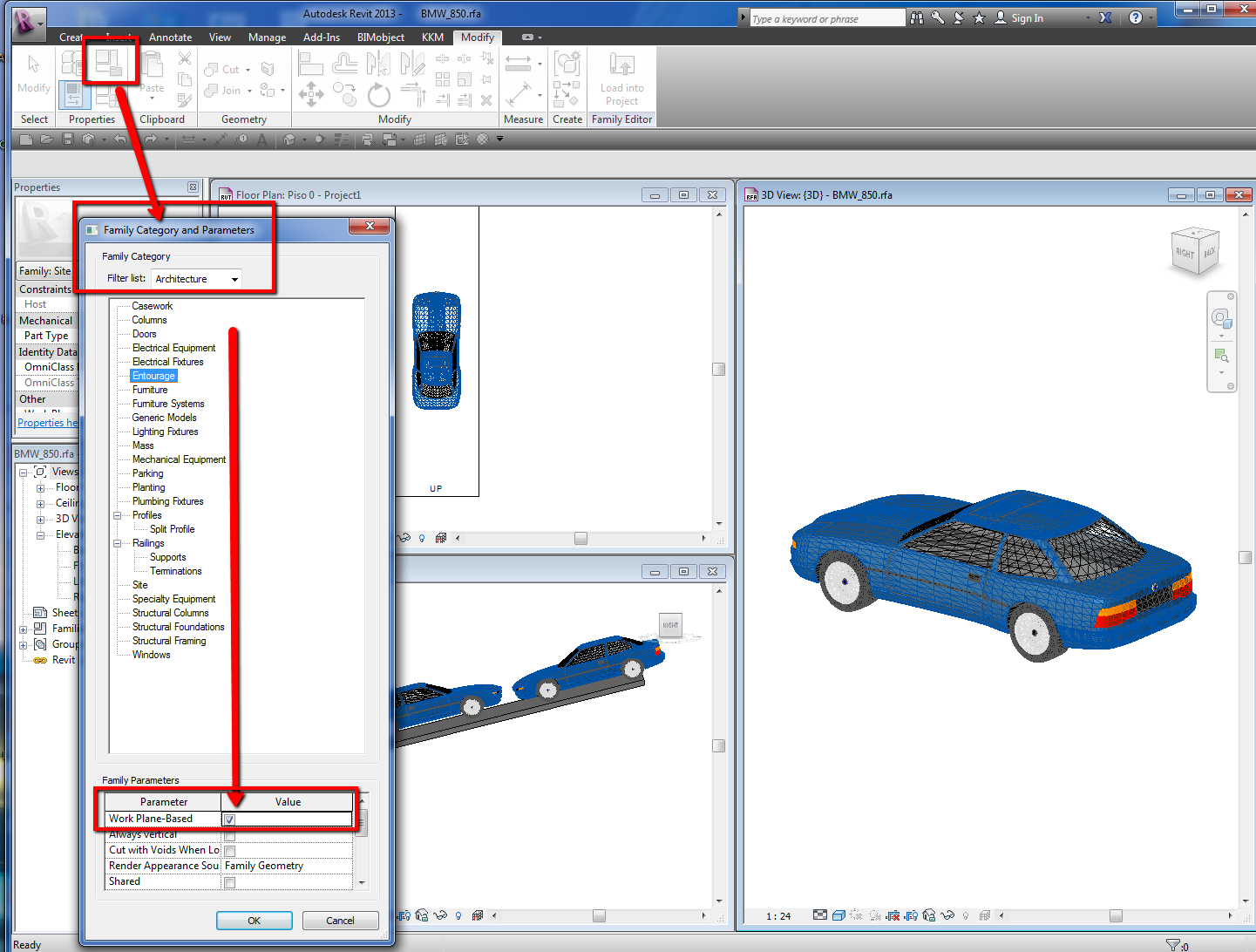

Edit that (CAR) family, goto "Family category and parameters", turn ON "Work-plane Based", load into your project, select the car and on Ribbon you will see "Pick New", select "Face" and now in a 3D view select the face of that RAMP, OR pick "Edit Work Plane" and select "Pick a new host" and select the face of the ramp.

Okay, Thanks Guys..Thanks Typhoon!!! . It Helped me a lot! Cheers!!! (: Thanks WWHub!
