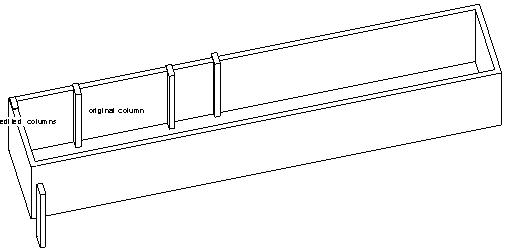

hello everyone i got little problem with my columns visiblity when i edit it from 0.45cm*0.45cm which is the original to 25cm*50cm it refues to show on my plan view  what could be the problem any ideal

Are you getting an errors or is it just disappearing?

is not an error but is just there, but not visible just when you get the mouse close to it then it show that it is there

Attach the family here and I will see if I can find out where you are going wrong.  Are you changing the column height constraints? Is your view range set correctly?  Do the columns show in 3D or section views?  Is this a Revit column or did you create this family?  Could be a few things.

what i did last to have the columns visible on my plan view was i split the wall covering the column then it became visible so am abit confuse on what to do
