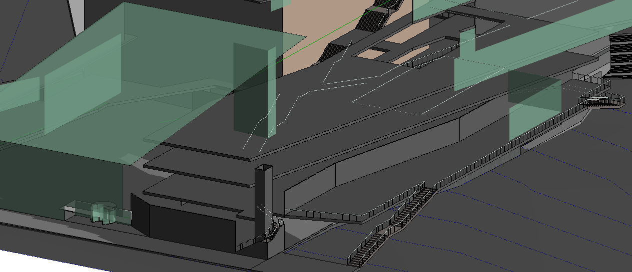

Hello, I have a very annoying visual display issue: my solid walls, floors are transparent to curtain walls or handrails that are actually in the back of them. I  have tried to adjust the visual graphics and theres no transparency set to my walls or floors. and seems that only handrails and glass curtain walls show through the solid floors/walls. ive attached a screenshot so someone can please help me out.

also im using 2013 version

Graphic card issue. Update your Drivers, also, turn off "Hardware acceleration" parameter.

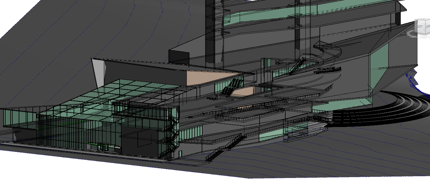

okay it worked great for a few hours now its again screwed up and even worse since its showing all the line work behind solid object

Still graphics issues.  Delete the 3D view and create a new one.
Note - Colors and shadows use a lot of memory as does constantly spinning the model in 3D.  If you have a limited system, you may want to limit these activities.
