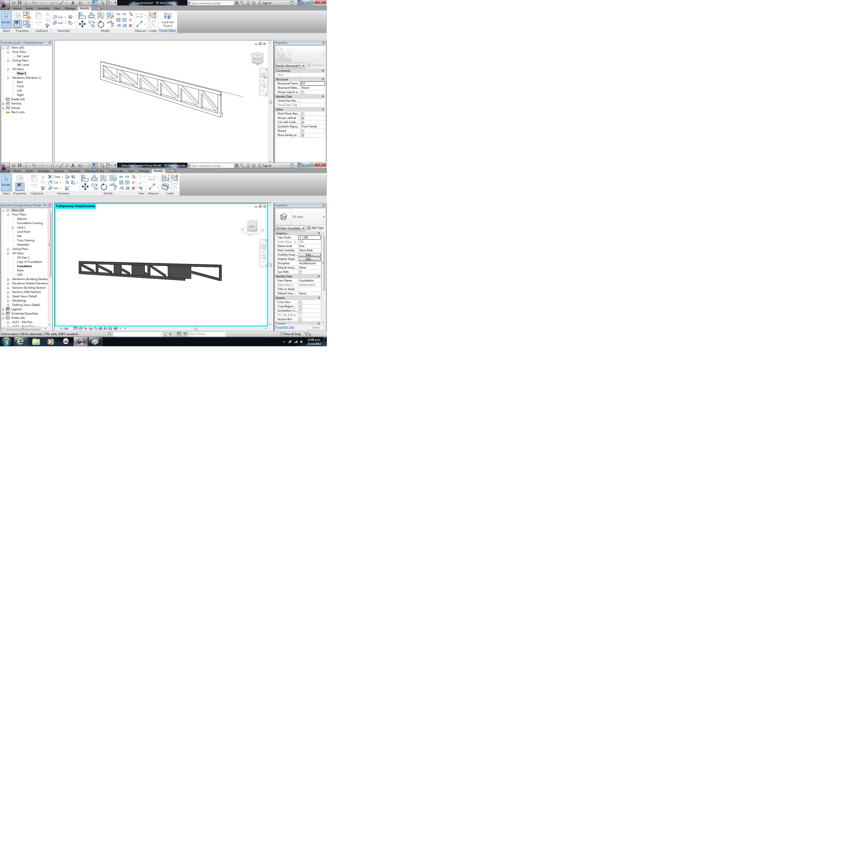

Hi guys i have problems with trusses the problem is on 3D i see the vertical webs fat and when i go on edit family it all seems fine even on 3D, planes, front,back elevations? just when i load them to my projects they all wrong and perfect on the actual family? do i need to create more perimeter can someone Please show me this with skectch maybe because iam really new to this family thing in revit i have snap shot for you attached here

Ohh by the way i have added the truss dimention on properties edit type to suit the project Lenght, maybe i went wrong there and moved the constrane lines?? i have use the generic family to create this truss

Flex the truss parameters in the FAMILY and see where the problem is.

lol yeap you were right that was the problem thanks for the reply
