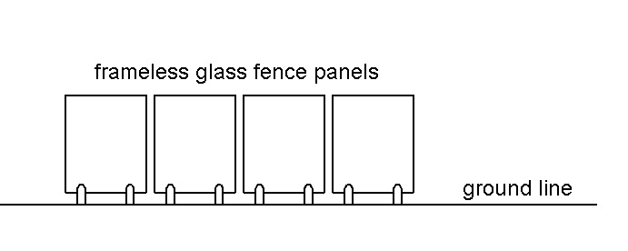

I was just wondering if anyone has any advice on creating a frameless glass pool fence? (See attached)
Below is a link to a manufacturer's website showing photos similar to the product we have used for other projects. We have however, been unsuccessful in modelling it in 3D.
http://www.dimension1glass.com.au/content/productinfo/anodised-aluminium-frameless-glass-spigots
At first I thought a curtain wall would be the right way to create this but have had not much luck in getting it to look as like those images.  A railing system doesn't seem complex enough to produce this in 3D.
Any advice/tips etc would be greatly appreciated.
Thanks in advance.

Continue with your first idea of a curtain wall. That's the way. But the main work is not in the curtain wall, but in the curtain panel family.
