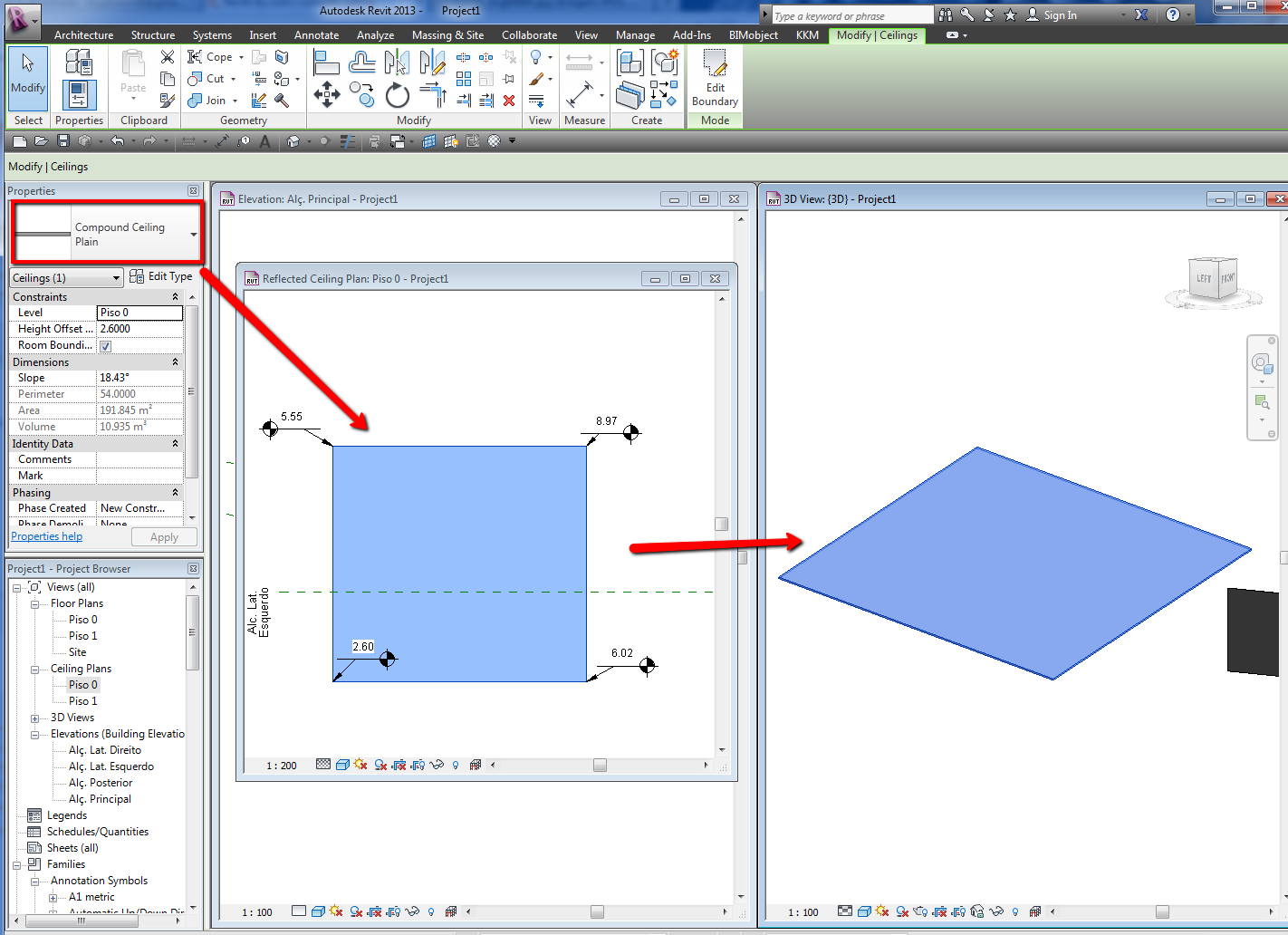

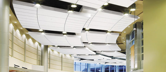

Hello all,
I am trying to create a ceiling system that is to reflect the Armstrong axiom floating ceiling system.  I was able to create a floating ceiling that is sloped so there are 2 different elevation points.  But I also need to slope it in another direction so there would be 4 different elevation points (each corner will be at a different elevation point).  Does anyone have any idea on how to create a complex roof like that? Any suggestions are appreciated.
the image attached is just for reference in what I am trying to create but I think this ceiling is flat.
JP

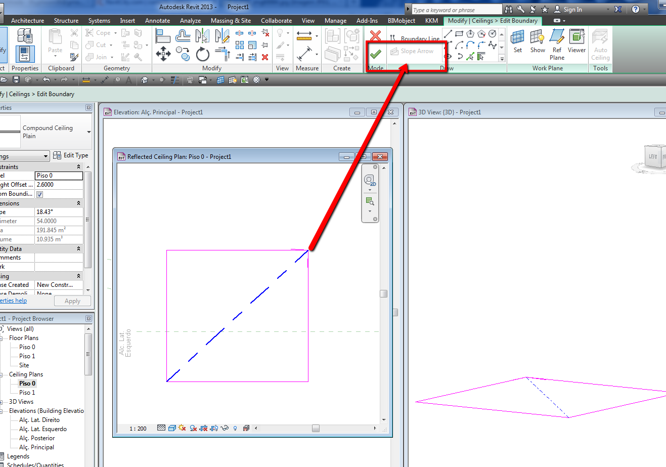

Use the "Slope Arrow"

Hi Typhoon,
I appreciate your answer. So I tried to slope the ceiling line and i found that the ceiling was only sloping in one direction
and not both directions.  I noticed in the image you showed that there are four different elevation points but I do not
understand how to get those points.  When i tried to slope multiple lines of the ceiling it is not letting me. What am I
forgetting to create the multi-slopes ceiling.  Thanks again for the assistance.
JP
Tue, Oct 23, 2012 at 2:44:55 PM | complex ceiling
You can place your slope arrow in any direction.
